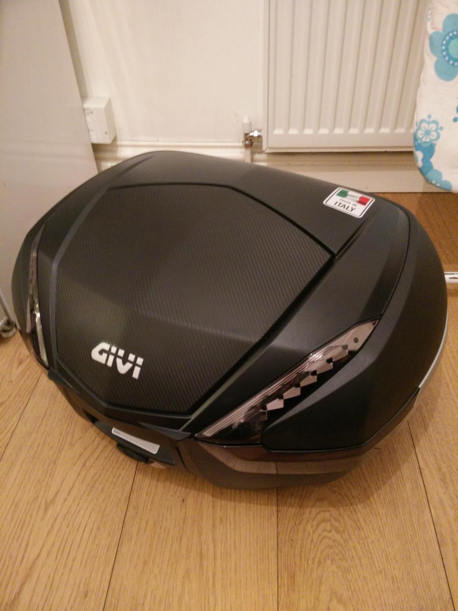

Also picked this up at what I feel was a reasonable price so will be fitting it tomorrow when the rack arrives.

Nice topbox, are the wee side panels (that look clear in the pic) good enough for brake or running lights? That would look awesome :-)
All fluids on the bike have been replaced. No worries there!
The top box is compatible with brake lights yea, might look into it in the future. Would look awesome but I'm not sure how it will wire up as I want the top box to be easily put on and taken off.

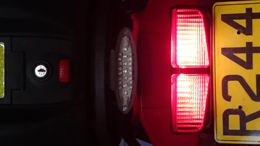

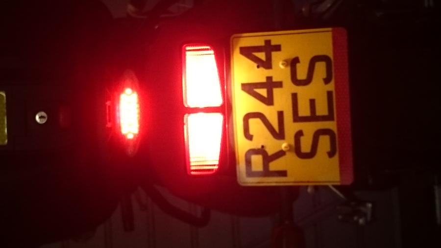

Here's my extra brake light I put on under my topbox bracket as I sometimes take my box off and this way it's always on the bike regardless of topbox being on or off and no wires to disconnect either, but I didn't have space to put led's without cutting the box somehow.

So after much trial and error the top box is fitted. The instructions supplied by givi were crap!
