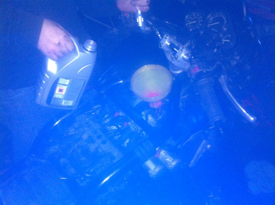

dark times @ chelmsford....thank fuck for smart torch :thumbup  the end of the day piccy...5 min after this the bike was purring like only a blue one can :car :photo
Re: Exhaust Studs - Exupnut - 10-02-13
and what about the choke cable? was that new? :uhuh
Re: Exhaust Studs - red98 - 10-02-13
nice work chaps  Wink  and not the warmest day of the year.....just odds and sods to do now then ?  Big Grin
Re: Exhaust Studs - Chris - 10-02-13
It's so blue it's tainted your photo  :lol
Gald you guys got it back together and running good  Smile
