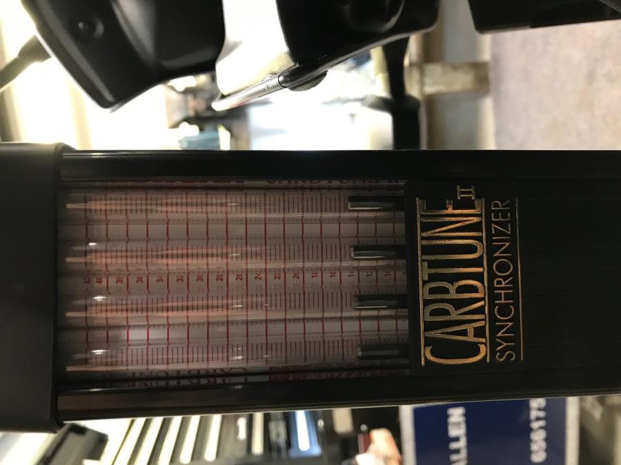

Re: finally ivanising.. - ogri48 - 12-01-19 remember when I first got the bike mike, and wasn't sure if it was already ivanised? I now know a simple test..if your sitting at 90 in top and whack the throttle open count four seconds and your now indicating 145, its ivanised.. Found some reasonably empty camera free motorway stretches today to try the new top end out a bit. Jeeeeeesus kerrist…. :lol :lol Re: finally ivanising.. - Falcon 269 - 12-01-19 That's certainly one way of checking it out, Paul. ![]() Re: finally ivanising.. - b1k3rdude - 12-01-19 (12-01-19, 08:35 PM)ogri48 link Wrote: I now know a simple test..if your sitting at 90 in top and whack the throttle open count four seconds and your now indicating 145, its ivanised..Yup, been there done that... a few times.. Re: finally ivanising.. - ogri48 - 13-01-19 :lol :lol :lol Re: finally ivanising.. - ogri48 - 13-01-19 borrowed daves carbtune today (cheers buddy), be interesting to see how far out mine are after the mods hopefully get on it tomorrow night after work

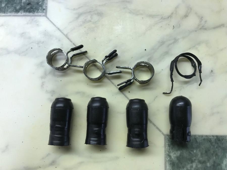

Re: finally ivanising.. - ogri48 - 14-01-19 balancing sorted...cheers dave.. they were a bit out to say the least Re: finally ivanising.. - ogri48 - 14-01-19 and I found a foreigner in the camp...new plug and clip ordered from fowlers... Re: finally ivanising.. - Dynspud - 16-01-19 Nicely done Paul. Have you taken the bike out for a spin since? Be interesting to see whether you notice a further improvement or not. Re: finally ivanising.. - ogri48 - 16-01-19 no was too cold by the time I finished last night dave, didn't feel like it. was going to tonight but been changing the tyres on me onda
