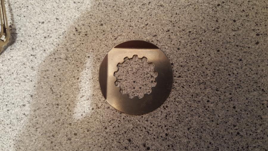

(29-01-17, 05:35 PM)fazersharp link Wrote: Actually at £10 its not that expensive (wonder how long it keeps after opening) I cant see myself using it for anything else.
Your cardboard tab picture is a good guide that explains the difference between a full fold up.Just a little thing you have your cardboard tabs opposite each other but the tabs are pre creased washer are adjacent to each other.
More info on the subject here http://foc-u.co.uk/index.php/topic,9920.0.html
http://foc-u.co.uk/index.php/topic,11851.msg130389.html#msg130389
Agrees with you on that one Sharpie about the washer being pre-folded.
Looking directly down on the washer it is impossible to use both of the pre-folded areas as the folds are a quarter of the circumference away from each other, making four sided pattern and the sprocket nut like all others has six sides so no mater how you position the washer only one of the pre-folds will line up.
I think it was designed to have just one fold up and having the washer pre-folds this way gives you a very good chance that one of the folds will line up.
I just did an opposite one for good measure.
