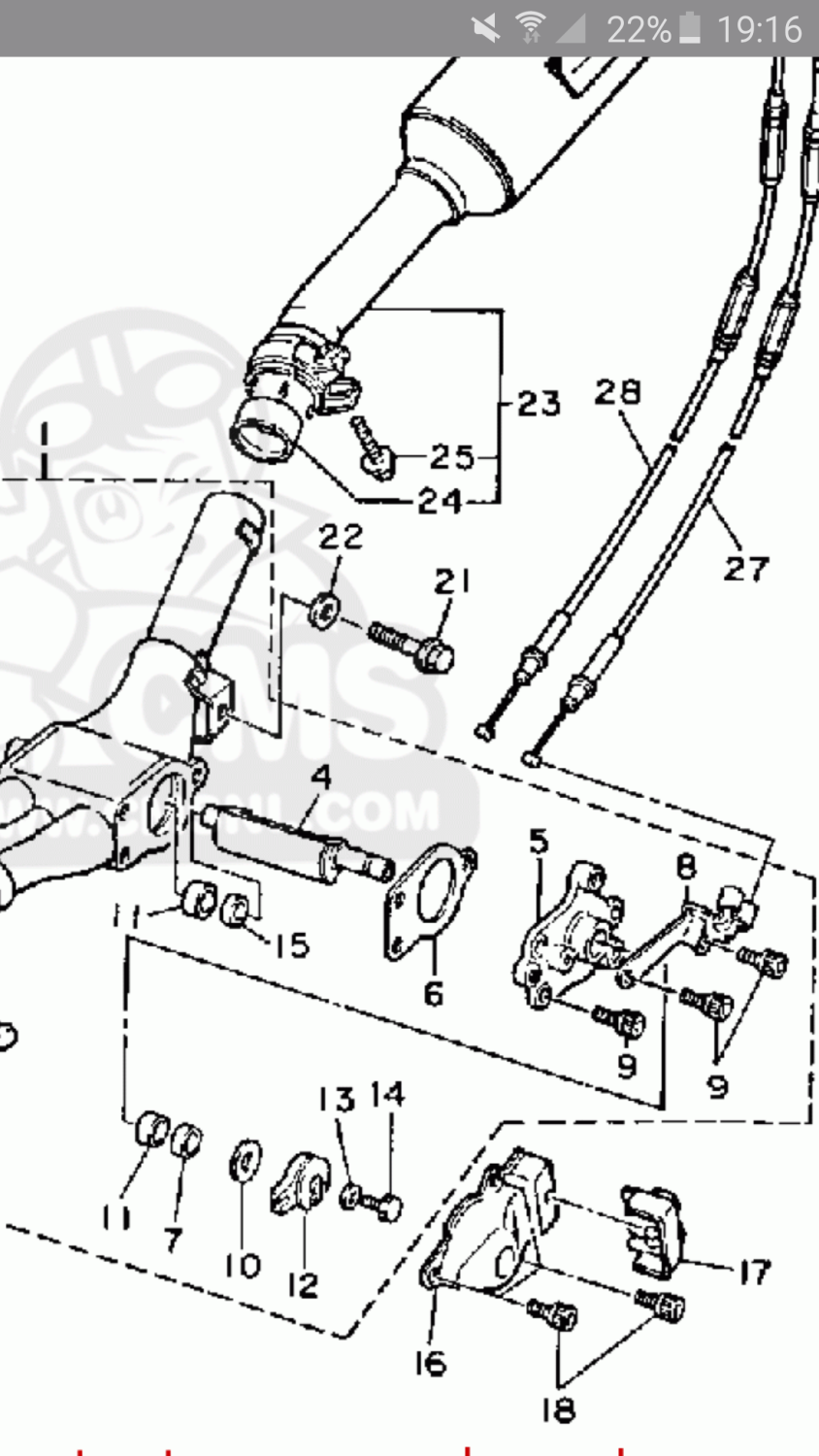

Exup's Boike Spruce-up! (Red made me post this) - Exupnut - 21-11-15
HURRAH!!!
Ordered 2 weeks ago and received today
[Image: 742149e7940dbbdec24b881ac33a0030.jpg]
Re: Exup's Boike Spruce-up! (Red made me post this) - red98 - 21-11-15
Bout time you posted  :rolleyes.......you going to tell us what it is then ............
Re: Exup's Boike Spruce-up! (Red made me post this) - unfazed - 21-11-15
Looks like an EXUP valve bush  :eek
Mmmmmm..........didn't think it was long enough for that.........come on FUDNUT put the cheap polski lager down and spill the beans....
Re: Exup's Boike Spruce-up! (Red made me post this) - dazza - 21-11-15
Looks like a genuine Yamaha cock ring custom made to fit exupnut's  member Big Grin
Re: Exup's Boike Spruce-up! (Red made me post this) - Exupnut - 21-11-15
Three words....fuck....shit....bollocks....:-)
Let me guess you bought the EXUP spacer instead of the bush  :lol
Re: Exup's Boike Spruce-up! (Red made me post this) - RMT1983 - 21-11-15
it's number 15 on the diagram
