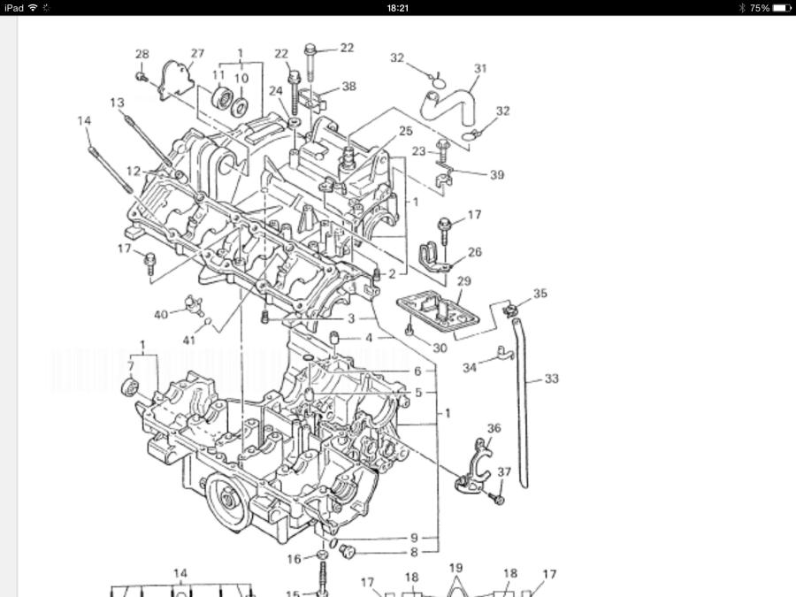

Re: Bit of a weird one - darrsi - 17-06-15
I presume 31 & 33
Re: Bit of a weird one - Jules-C - 17-06-15
Pipes connect to both front bottom corners of the air box. If the pictures load in one of them you can see it between the idle adjuster screw and the clutch cable.  The pipes connect to a T piece and then join the pipe coming out the top of the gearbox. There is a black plastic connector that has a piece of sponge in it that acts as a firetrap to stop you setting fire to the oil in the engine if the bike backfires through the air box.
(17-06-15, 06:22 PM)darrsi link Wrote: I presume 31 & 33
31 and the other pipes will be on airbox fiche.  Don't recognise 33 it might be the tank breather for the later models

https://www.YAMAHAmotorcyclespares.co.uk/genuineparts/9656/10/yamaha%20fzs%20600%20fazer/intake?uID=0
Re: Bit of a weird one - anutz - 17-06-15
good find - exactly as mine is layed out
24 is news to me, that MUST be clogged up?
That number 24 jobbie.
