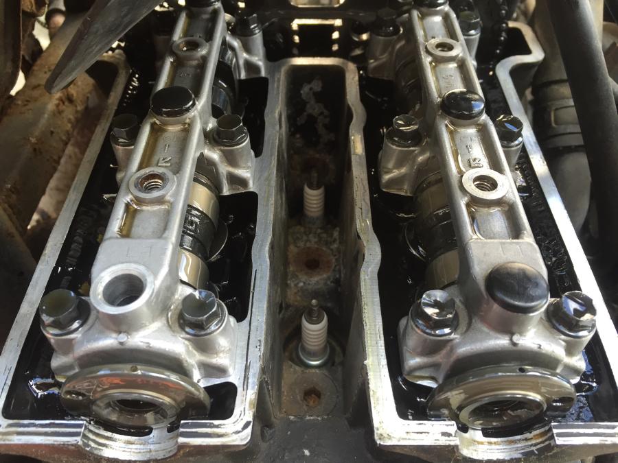

Re: Refitting the timing chain... - Paulfzs - 26-04-15 yeah the carbs where a pain!!! getting the carbs in took some pushing and loads of lube once they where mostly in i pushed the airbox in as best i could then just got the jack handle in the airbox gaps which look made for this task and gave em a good shove, popped in eventually then done up the jubilee clips. Re: Refitting the timing chain... - anutz - 26-04-15 Its done! It runs nice - I think - just loading a video now! Have not done the sprocket etc but the engine works Whooooo! Have not tightened down the downpipes yet or the link pipe so a little crackle some times But its past the first test, radiator warmed up as well so no issue with air locks, and no leaks Re: Refitting the timing chain... - unfazed - 26-04-15 Well done, :thumbup Remove the filler cap and recheck the coolant level when cold. Re: Refitting the timing chain... - red98 - 26-04-15 :thumbup :thumbup :thumbup :thumbup :thumbup Re: Refitting the timing chain... - Tommyk - 26-04-15 Anyone know of a possible timing mod Reason being I decided to balance my carbs, thought it best to check valve clearance first They were spot on. When I turned the engine for #1 tdc noticed my exhaust cam was not aligned with the cam mark but was in the One o'clock position My engine sounds right runs good and valve clearances correct so decided not to worry about it But it's bugging me so the only conclusion I can think of is that the previous owner had intentionally set it like this as a power mod ? Re: Refitting the timing chain... - anutz - 26-04-15 Here is the video of it! https://vimeo.com/126061790 Re: Refitting the timing chain... - anutz - 26-04-15 regards the cams being out - maybe they just settled for it as it was, I don't know if it would be a mod....but durations of open/close will affect running.. As many said on my pictures I was a sprocket out, it took a long time to figure out how to take up the slack with a sprocket and small clockwise turn - have done it 2 times now as I had to do valve clearances... If its working fine then you may be best to leave it - but if you a like me then you might not be able to resist Put some marks on it now so u can see which chain link matches with which sprocket tooth I did not do that and it has taken me ages - but the 2nd time was quicker as they gave me a good guide to where I needed to be Re: Refitting the timing chain... - unfazed - 26-04-15 (26-04-15, 08:55 PM)Tommyk link Wrote: Anyone know of a possible timing mod No power mod, it is a tooth out. I have seen it before where the owner thought it was close enough, he did not realise it was a tooth out. Engine were running fine before and when we fixed it he did not notice any difference. Before I changed my cam chain it was over a tooth out because the chain had stretched so much, it was running fine except for the rattle and to be honest I did not notice any difference either. Re: Refitting the timing chain... - Tommyk - 27-04-15 Ok thought it might be a clever timing/extra power mod but if nobody else has heard of it Then I'm definitely gonna reset it to correct timing as I can't accept it not being incorrect Takes a few turns to start from cold hence the valve clearance and carb balance check Hopefully this will solve the cold start riddle as runs perfect when up to temp Re: Refitting the timing chain... - anutz - 27-04-15 Good luck! Remember mark it first - I used Tipex :lol Re: Refitting the timing chain... - Deefer666 - 28-04-15 The trick to setting cams is keeping all of the cam chain slack toward the back of the engine and counting the chain pins between the two timing marks..... Easy |
