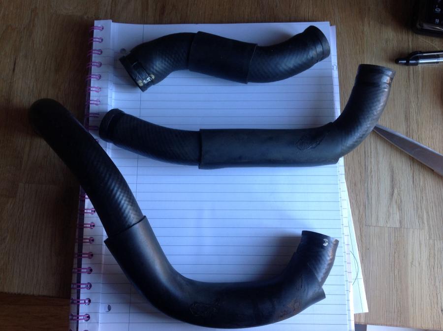

I have wrapped the "holy" water pump outlet hose in the two part "haris pipe and hose repair tape". It was horrible to do it as there was very little room behind that pipe, and I suspect if it would actually contain the leak. I haven't started it, just in case if this self-amalgamating tape thingee needs time to set. Will see how it's in the morning. Does anyone here have one of these yokes lying around, perhaps from upgrading to fancy kit?

The rad hose.....ok I kept my old rad hoses for this reason....but some may be missing...post up a pic of the one you need and ill have a look.......if you pay postage on it then you can have it.....if I have it.

Have you checked where the pipe is leaking from? It might have just moved from the fall rather than split. If you want to get new Yamaha parts use this parts manual http://foc-u.co.uk/index.php?action=downloads;sa=view;down=13 Danfay are the main Yamaha parts dealer in Dublin. If you call them up and quote the parts number they'll give you a price.

His Dudeness, yes, can see a half a centimeter split/hole just about a centimeter below where it clamps onto the metal pipe going to the radiator. Thanks for the link, I think I have found the part numbers (from page 7), and it's called "hose 6"
07 90467-26189-00  Clip
08 90450-32051-00  Hose Clamp Assy
11 4YR-12589-00-00 Hose 6
Didn't know Danfay was the main dealers, and they are in Sallynoggin which is just 15 mins from my work address. Brilliant stuff!
Meanwhile, the guy breaking a Fazer has confirmed he has both the chain adjusters and the 'bottom water hose' as he calls it, so I might pick it up later today.

Right then positron.........which hose do you need.
Top
Middle
Or
Bottom????
