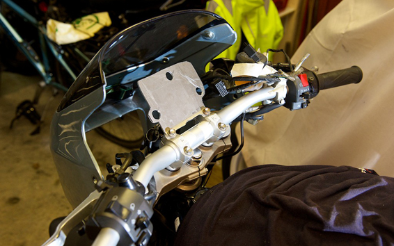

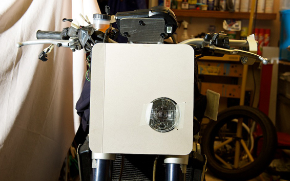

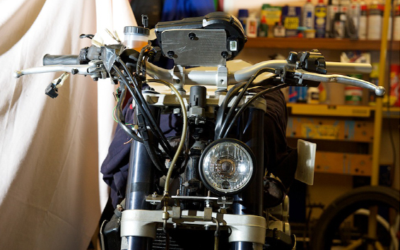

Day 40 - 15-2-14 - I've decided to redesign my speedo bracket. Although I've been trying to mount up the bikini fairing, that's mainly intended for the race bike set up. For the road I'm
planning on a large AMA race bike type number board, incorporating a small headlight to keep things legal and for practical night time use, although I hardly ever ride at night unless I'm in Europe. I
need the speedo to be much closer to the yokes, well as close as possible, so the gap between forks and number board is not too great. That would look well nasty!
[Image: RubyRacer-68-s.jpg]
I did buy some headlights from a B Whizz scooter as they were nice and small. I was just going to use one of them, however I've rejected them as one light is only 10 watts! I'd be lucky to see
the white line in front of me, let alone the road ahead. So I've bought a single Dominator headlight, which is a dual filament bulb 60/55 watt. It's only 90mm wide so about the smallest I could find. I
didn't really fancy projector headlights for two reasons. First I wanted a more retro look and second, you have to have two, one for dip and one for main. I just want one light. I'm going to have to
fabricate a different rear section to the light as the one it comes with is too deep.

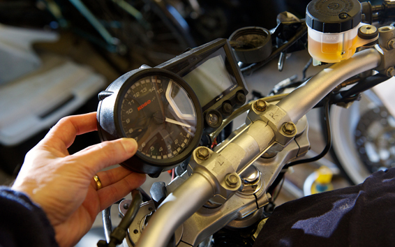

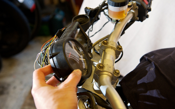

Day 41 - 23-2-14 - I made a new speedo bracket at college last Tuesday evening. However even before making it I'd redesigned it! Originally I thought I would mount it above the top yoke
using the M10 bolts that hold the handlebar clamps in place. Then I realised this would look very nasty and decided to use the same bolts, but mount it under the top yoke.
When I fitted it it made the speedo stick out too far forward. So I redesigned it yet again! This time I used the M8 bolts at the front of the top of the handlebar clamp. This gets the speedo further back,
however it does make it harder to read as it's closer to the rider. Think I'll just have to live with that as I don't want my number board mounted too far in front of the forks. In fact I want it as close as possible.

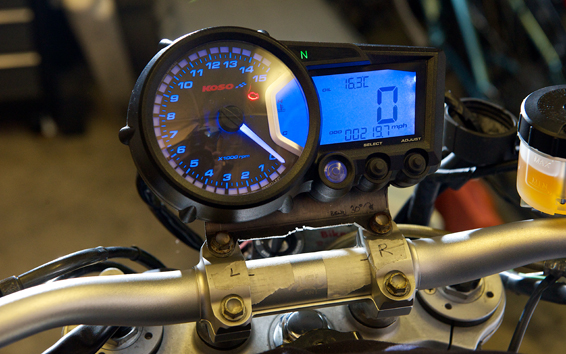

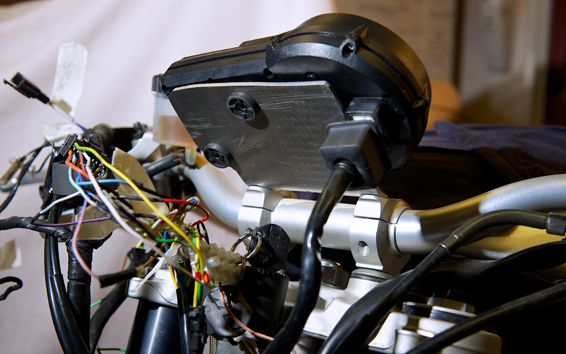

Day 42 - 2-3-14 - Spent some time getting the Koso speedo temporarily wired up to check it works and in readiness for a road test (hopefully in a couple of months time). I didn't want to cut
any connectors off just yet so have jammed the wires from the Koso into connector for the OE speedo. Also made a note of what wires connect to which to save time in the future.
[Image: RubyRacer-73-s.jpg]
[Image: RubyRacer-74-s.jpg]

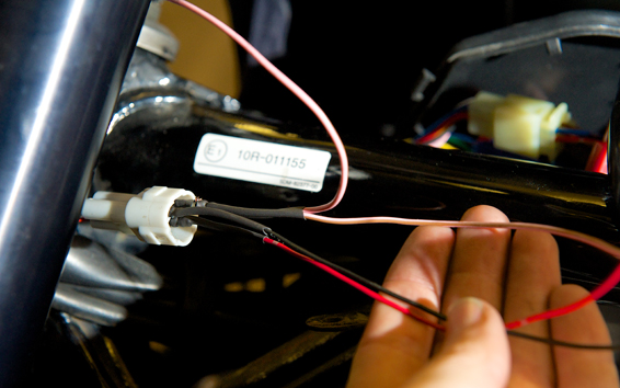

The wiring from the OE speedo sensors shows two wires go direct to the speedo whilst the Black/Blue goes to the pick up coil. It's only a theory at this point, which I've mentioned earlier, but I reckon
that the reason those who have fitted different speedos in the past get error codes displayed on the rev counters is because they lose this connection to the pick up coil by wiring the speedo sensor only to
the after market speedo.
I'm hoping to avoid this issue by maintaining the connection to the pick up coil by splicing in an extra wire, so the wire from the speedo sensor goes to both the pick up coil and the Koso speedo. Only
a road test will tell if this works, which will hopefully happen within a month or two. Even if my theory is correct I may be messing things up because I'm using the KTM wheel speed sensor and this may be
calibrated differently. We'll see, all part of the fun of the custom build.

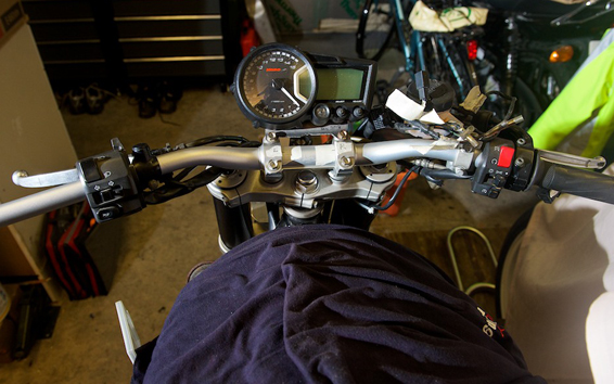

Day 43 - 22-3-14 - I don't believe this! I'm onto my third choice of place to mount the speedo. I don't like it mounted on the handle bar clamps. Too high for my liking and also really hard to
get at the ignition key to turn it on and off. So decided (for the moment LOL) that I need to mount the speedo on the ignition switch mounts on the top yoke.
[Image: RubyRacer-76-s.jpg]
That means the ignition key barrel has to move. Looks like I'm going to have to mount it like the chopper builders do, somewhere under the top rails of the frame. I'm thinking in the area that the airbox
currently resides. That will be going once I get the pod filters fitted, so nicely tucked away under the tank perhaps?
Need to take the top yoke to a fabricator to get the bolts out so the ignition switch can be removed. The manufacturers use bolts which have no heads to deter thieves. I think the way they normally
get them removed is to weld a nut onto the bolt so you can get a spanner on them.

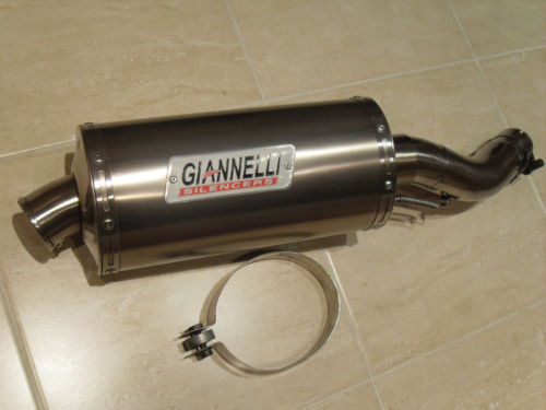

until I get the bike rolling again. This is phase one and once I know the bike rides OK with the new front and rear end I'll be moving on to phase two, which will be fitting a new Venom (cheaper Motad)
stainless exhaust system, pod filters and a carb rejet to match. I've also got a rather nice stubby Gianelli can to fit. It was made for a ZX-10R, but it has the same inlet size as the standard pipe so should
go straight on. If not some modifications will be made!
