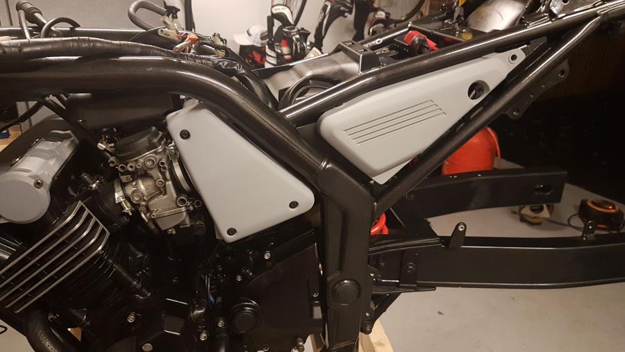

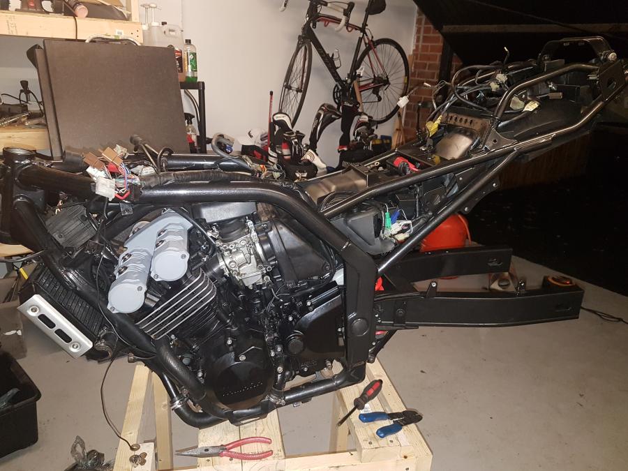

Re: Restoraion - bikemad - 17-11-16 Bottom of airbox is just drain pipes & on the carbs it's a breather mines not attached to anything Re: Restoraion - Wootan - 17-11-16 Thanks, much appreciated Re: Restoraion - Wootan - 17-11-16 Picture update Re: Restoraion - celticdog - 29-11-16 Excellent finish on the airbox and infill panels fella, looks just like anodised aluminium. :thumbup Re: Restoraion - Chris - 01-12-16 Looks great! So pleased to see the progress on it. Like the attention to detail, Chris Re: Restoraion - Fazer99 - 01-12-16 WOW! you're doing a cracking restoration job :thumbup Re: Restoraion - Wootan - 03-12-16 Thanks Chaps, Anodised Aluminium, also know as primer :lol. Starting on the forks tomorrow, everything looks pretty grotty so should be interesting. I'll get some pics up tomorrow. Re: Restoraion - joebloggs - 04-12-16 What paint did you use on the motor and did you etch prime the cases first? Re: Restoraion - Wootan - 04-12-16 I used a specific engine paint and etch primer. It wasnt cheap but worked really well, especially for brush painting. I soda blasted everything first then 3 coats of each. Let me know if you want a link to the paint. Re: Restoraion - joebloggs - 06-12-16 (04-12-16, 06:51 PM)Wootan link Wrote: I used a specific engine paint and etch primer. It wasnt cheap but worked really well, especially for brush painting. I soda blasted everything first then 3 coats of each. Let me know if you want a link to the paint. Link would be great Thanks Re: Restoraion - Wootan - 08-12-16 Here you go, sorry for the delay. https://www.paragonpaints.co.uk/ Re: Restoraion - devilsyam - 10-12-16 what is soda blasting Re: Restoraion - Wootan - 18-12-16 Shot blasting but using soda as the media Re: Restoraion - devilsyam - 18-12-16 as in cokacola or sprite or even monster Re: Restoraion - Graham53 - 18-12-16 Soda is an abrasive used in sandblasters but its soft enough that it doesn't damage surfaces but cleans off ingrained dirt and staining , it's a bit like washing powder (or in the US of A it's called washing soda) but for use with high pressure cleaning systems. ( didn't know if Devilsyam was joking sorry ?) Re: Restoraion - devilsyam - 21-12-16 i wasnt never heard of it as a blasting service Re: Restoraion - joebloggs - 23-12-16 (21-12-16, 11:32 PM)devilsyam link Wrote: i wasnt never heard of it as a blasting service Devilsam, if you go on youtube you'll find video's of people blasting complete engines, something you couldn't do with other media as it would risk destroying the motor if it was to find its way inside a casing Re: Restoraion - joebloggs - 23-12-16 https://www.youtube.com/watch?v=gmjEG7_5a38 Re: Restoraion - nash - 18-02-17 Any progress in this restoration? So far you did a really good job. :thumbup Re: Restoraion - Wootan - 25-02-17 (18-02-17, 11:34 PM)nash link Wrote: Any progress in this restoration? So far you did a really good job. :thumbup Thanks Nash. I've not had a great deal of spare time recently but a little progress has been made. I've replaced the rear shock and started the rebuild on the front forks. Pics below. |
