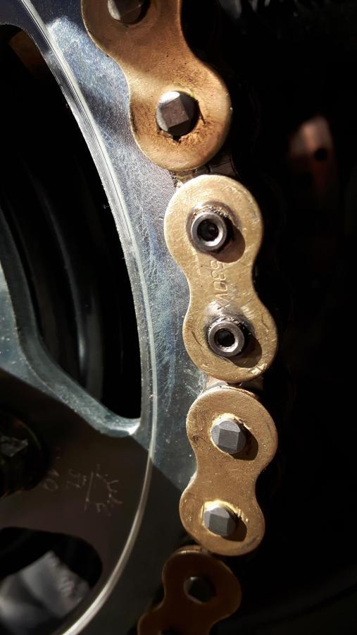

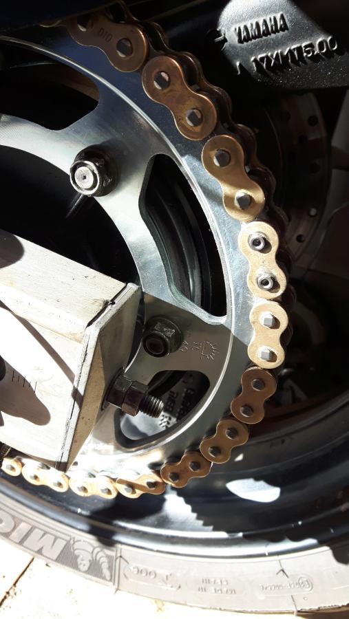

Re: what did you do with your fazer today ? - sinto607276 - 26-04-16
(19-04-16, 07:13 PM)MMCMME link Wrote: [quote author=sinto link=topic=6412.msg229618#msg229618 date=1460914048]
[quote author=MMCMME link=topic=6412.msg228813#msg228813 date=1460275540]
MOT just done on Friday with no printed advisories.
Guy recommened new chain and sprockets so back end stripped ready for parcel arriving tomorrow!
[Image: 78IJoBL.jpg?2]
I've just ordered a set too, let me know how it goes as this'll be the first time I've actually changed a chain on a motorbike, yes I know it's totally disgraceful with all the years riding I've done :lol
Was a nice real easy job surprisingly! Make sure you have a chain riveting tool handy for the final link as I never  :lol
Took me longer to clean all the crap from the casings and re-allign the rear wheel than it did to do the job itself!
I was also hoping that a new correctly tensioned chain would help to eliminate some of the typical Yam gear change clunk, but, nope....
Stripped the rear end down and gave it a good clean, also greased the swing arm bearings all ready for the new chain and sprockets that were delivered today so I'll fit them tomorrow.
By foc was the front sprocket hard to come off! Bit what do you expect after 18 yrs and 28,400 miles :lol

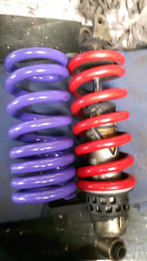

Oh the 4th pic is of my new rear shock spring but can't figure out how to get it replaced as I can't remember where my shock spring tools are Sad so that'll need to wait till another time I guess Sad
Nice! Nothing better than getting your hands dirty Smile
Luckily i didnt have to remove my swingarm (probably should have though...)
Think I got quite lucky as front sprocket nut looks as though it was changed at some point so wasnt too tight at all.
Did you check tool pouch under your seat for shock spanner?

(27-04-16, 07:03 PM)sinto link Wrote: Just hoping I've managed to put enough pressure on the link rivets for it to hold, don't know if they're over far enough got my liking Sad
Looks good to me Colin  :thumbup
Re: what did you do with your fazer today ? - sinto607276 - 27-04-16
(27-04-16, 08:51 PM)Freck link Wrote: [quote author=sinto link=topic=6412.msg230521#msg230521 date=1461780199]
Just hoping I've managed to put enough pressure on the link rivets for it to hold, don't know if they're over far enough for my liking Sad
Cheers Freck, might sleep a wee bit easier tonight :thumbup

(27-04-16, 07:03 PM)sinto link Wrote: Just hoping I've managed to put enough pressure on the link rivets for it to hold, don't know if they're over far enough for my liking Sad
Looks good to me, many over do it and can crack the head of the rivet. Measure the diameter of the flared end
Recommended flared diameter of the rivet  for a 530VX chain is between 5.7mm - 6mm  :thumbup
