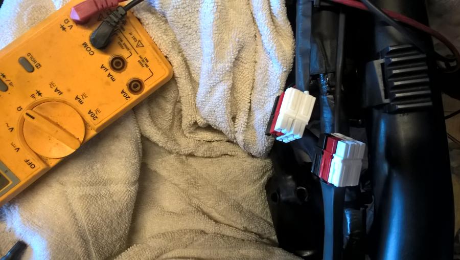

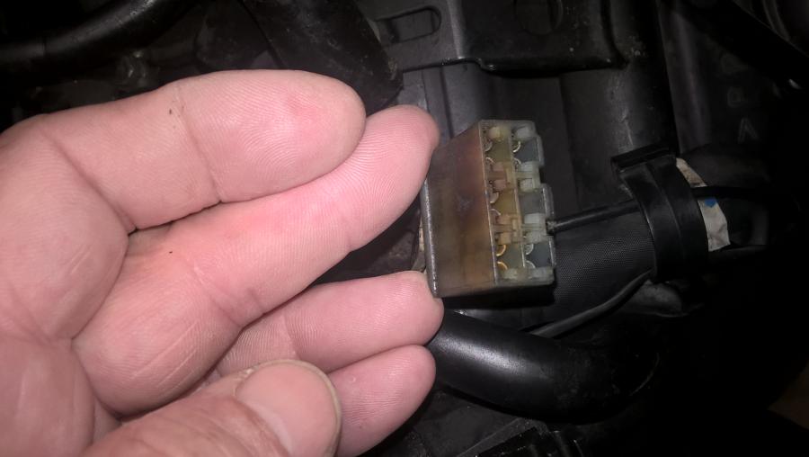

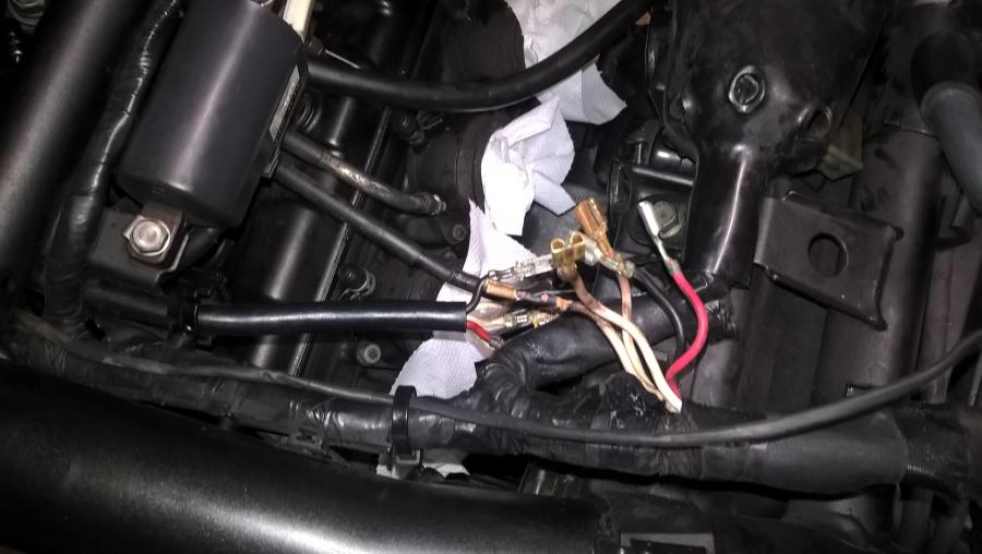

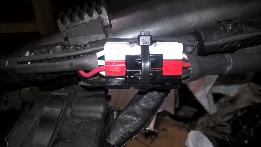

Re: Intermittent fault. Bike won't rev past 6000rpm - unfazed - 08-05-19 Had to do the connector to the Regulator/Rectifier and Alternator on the 1000 also, see pics. I used Anderson Powerpoles (Torberrys) connectors Re: Intermittent fault. Bike won't rev past 6000rpm - robbo - 08-05-19 Didn't know which company specialised in the connectors, so just blundered around the net until I hit on the make Dent-de-lion, which looked very similar to the ones in PieEaters attatchment. Hopefully this mod plus a change of regulator will remedy this very intermittent fault. Re: Intermittent fault. Bike won't rev past 6000rpm - ram - 09-05-19 these are good for vehicle wiring bits and nearby to me http://www.vehicle-wiring-products.eu/ they do the powerpole ones here: http://www.vehicle-wiring-products.eu/section.php/159/1/powerpole-connectors |
