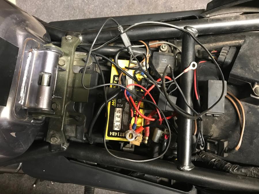

Re: finally ivanising.. - VNA - 02-01-19 Quote:It was fast before, and it was good before. But now, its definitely faster, and its definitely better. God I love this bike...Well done Ogri. Brave man too. Mike did mine back in 2005 - slip on kit. The things I noticed straight off (I can still remember) was a much stronger pick up at about 2.5K with the throttle wide open. Then that extra surge towards the top end. But best of all, no surging at small constant thottle openings. Mine will roll through towns at 30-35 mph in 6th, before I had to knock it down to 4th and it would still surge. Well worth doing. Re: finally ivanising.. - ogri48 - 03-01-19 cheers vna..yup, both me and dave noticed the huge improvement in that area mate. Just wish id done it two years ago One of the worst jobs was the daftest..ive connected all manner of shite to the battery over the last two years (heated grips, optimate lead, garmin hard wire, accessory fag lighter/usb unit)and messing about re connecting everything along with siting the fuse boxes and over long wiring was ridiculous..in prep for whipping them off again I cut everything back tonight, changed all the fuses for micro blades, then soldered /heat shrunk everything onto just the single leads..another job I should have done ages ago really.. :lol :lol
Re: finally ivanising.. - mtread - 03-01-19 Mine's the top one :rolleyes Re: finally ivanising.. - Falcon 269 - 03-01-19 That made me laugh, Paul. The number of Fazers I worked on that had battery wiring like yours, as though they were powering every accessory in Halfords. ![]() Nice job now.
Re: finally ivanising.. - Dynspud - 03-01-19 Top job on the wiring mate :thumbup Another one on my to-do list now.........
