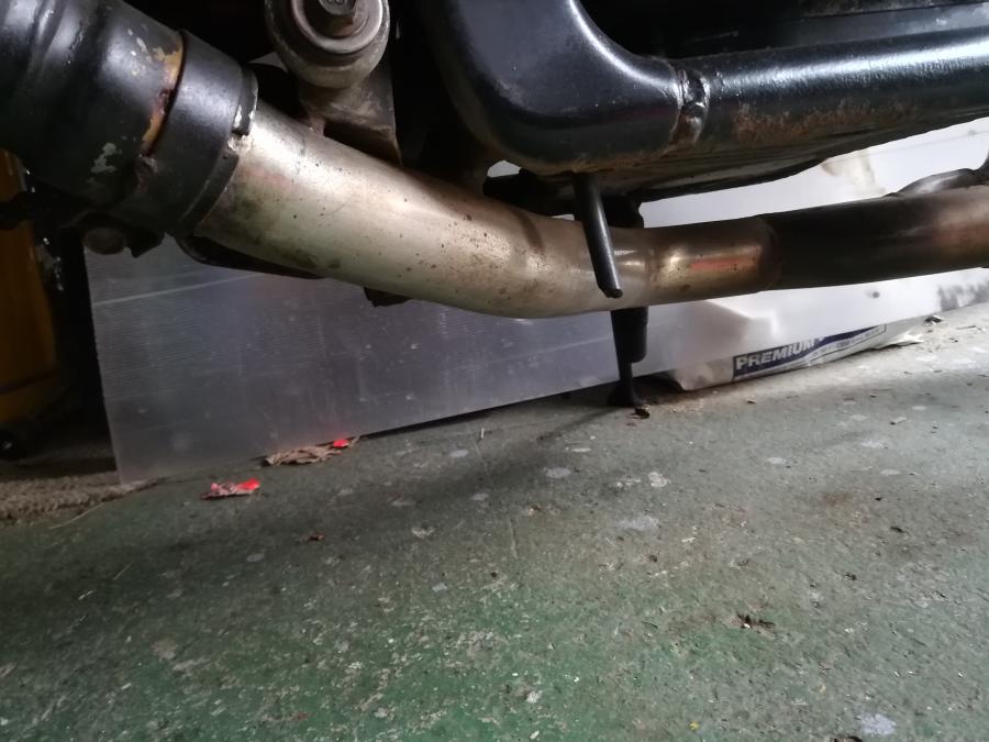

Re: Exhaust identity - deeteefifty - 13-09-18 As requested bandit. Re: Exhaust identity - bandit - 13-09-18 (13-09-18, 05:58 PM)deeteefifty link Wrote: As requested bandit. Still no wiser on the the down pipes & black widow are talking out of their a**e , because when you remove the jubilee style black clamp on the original & remove the silencer the link pipe then attaches to that end without the gauze gasket inside & the other connects to the silencer. Look at this picture, where the black downpipes end is where the link pipe connects & then connects to the silencer the original silencer comes with the link pipe & silencer as one piece, hope this helps. https://www.gumtree.com/p/yamaha-motorbikes/yamaha-fazer-600-1999-t-reg-not-bandit-hornet-streetfighter-cheap-bike/1274646165 Re: Exhaust identity - YamFazFan - 13-09-18 (13-09-18, 04:35 PM)bandit link Wrote: [quote author=YamFazFan link=topic=24546.msg284236#msg284236 date=1536852246] Stainless painted black on the Foxeyes. [/quote] Nope steel painted on foxeyes same as boxeye, only stainless on FZ6. [/quote] I read it ages ago here in this Bennetts buyers guide in the 'Any Updates?' section. Must be bad info. https://www.bennetts.co.uk/bikesocial/reviews/bikes/yamaha/yamaha-fzs600-fazer-1998-2003-buyers-guide My original downpipes are still like new with all the factory paint still attached. Re: Exhaust identity - unfazed - 13-09-18 Looks like Lextex Stainless Downpipes Re: Exhaust identity - deeteefifty - 13-09-18 Thanks again everyone. Unfazed it does look close to a Lextek. Re: Exhaust identity - bandit - 13-09-18 The original downpipes for 98 & 03 share the same part number & same price for new ones, £1,204.68 if Yamaha had later made them in stainless the price would have been nearly half the price of the bike new. [img alt=Cheesy]http://foc-u.co.uk/Smileys/efocicon/cheesy.gif[/img] deeteefifty, hope that sorted your queries & you get a new silencer & link pipe sorted soon. Re: Exhaust identity - deeteefifty - 14-09-18 EEK! How much? Thanks again, there's an astonishing amount of shared knowledge on here from you chaps. I'll update my progress when done. Re: Exhaust identity - darrsi - 14-09-18 (13-09-18, 11:33 PM)bandit link Wrote: The original downpipes for 98 & 03 share the same part number & same price for new ones, £1,204.68 if Yamaha had later made them in stainless the price would have been nearly half the price of the bike new. [img alt=Cheesy]http://foc-u.co.uk/Smileys/efocicon/cheesy.gif[/img] Hmmm, 2002 details have chucked up something interesting. http://foc-u.co.uk/index.php?topic=34.0 Re: Exhaust identity - bandit - 14-09-18 Not sure all info is correct, Exhaust angle lowered to accommodate longer pillion pegs? Deep Reddish Yellow Cocktail wasn't available in the u.k in 98 only red or black, when I bought mine in 98 a customer paid the dealer to have one sprayed yellow. Re: Exhaust identity - YamFazFan - 14-09-18 A magnet sticks to my down pipes. That would confirm that they're plain steel under the paint wouldn't it?. Re: Exhaust identity - darrsi - 14-09-18 (14-09-18, 08:49 AM)bandit link Wrote: Not sure all info is correct, Some of these websites are bad for that. There's a couple that don't give the choice of it being black, and another site doesn't list it as a 2000 SP model which it blatantly is, if i use the reg number. Says it's a 98 i think. Re: Exhaust identity - deeteefifty - 14-09-18 YamFazFan, lower grade stainless can be magnetic, try some knives and forks, probably should be classed as rust resistant. Re: Exhaust identity - jskelton555 - 26-09-18 My 03 fazer has stainless downpipes painted black from new. Think it was only last year 03 they did this Re: Exhaust identity - fazersharp - 02-10-18 (14-09-18, 03:38 PM)deeteefifty link Wrote: YamFazFan, lower grade stainless can be magnetic, try some knives and forks, probably should be classed as rust resistant.Thats right about the lower grade stainless sticking to a magnet but sometimes you can tell with a magnet that although it sticks, it is not so strong a stick/grab as plain steel is. Try a definite plain steel straight after to see if there is a difference. To prove about some stainless being magnet, try some cheap kitchen sinks and you may find that the bowl won't stick but the drainer does. Re: Exhaust identity - YamFazFan - 02-10-18 Just tried the sink/drainer and a magnet won't stick to any part, but it does grip every piece of cutlery I've tried in the drawer that's marked 'Stainless Steel'. Re: Exhaust identity - deeteefifty - 02-10-18 :lol Stainless is heavier than mild steel too. You can go about with a set of scales if it helps. Re: Exhaust identity - YamFazFan - 02-10-18 Good job Gordon Ramsey isn't due round our kitchen. Can't see the cutlery passing his quality control :lol |
