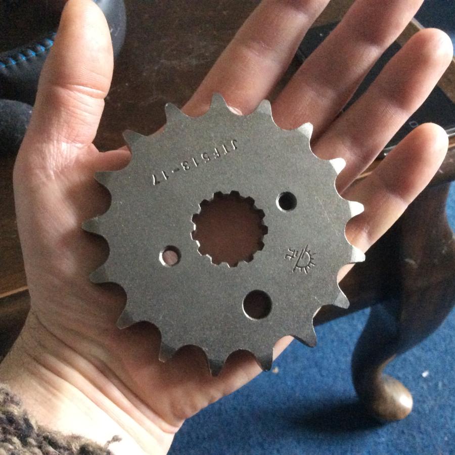

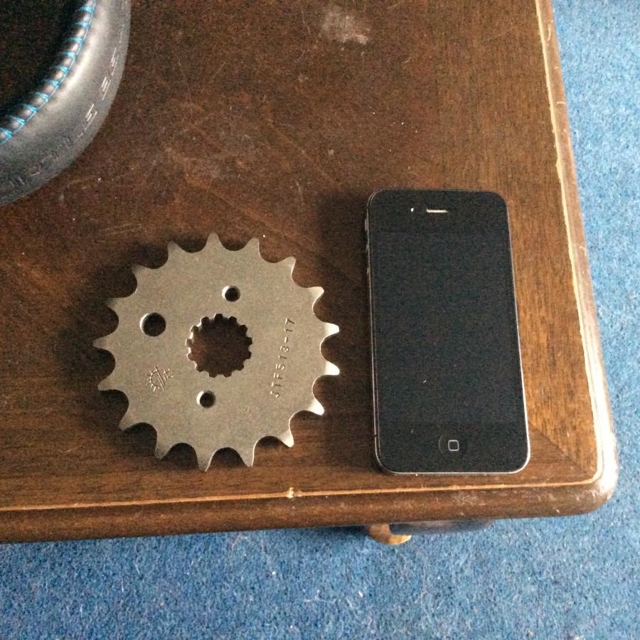

17 tooth sprocket arrived today, big bastered... as soon as it stops raining I'll attempt to fit it and let you all know my opinion.

Re: Bigger front sprocket - Triggergee - 03-04-18
Bad news foccers, 17 tooth doesn't fit  :'( chain just not quite long enough. I'll contact JT at some point and see if I can get extra links for the chain.
