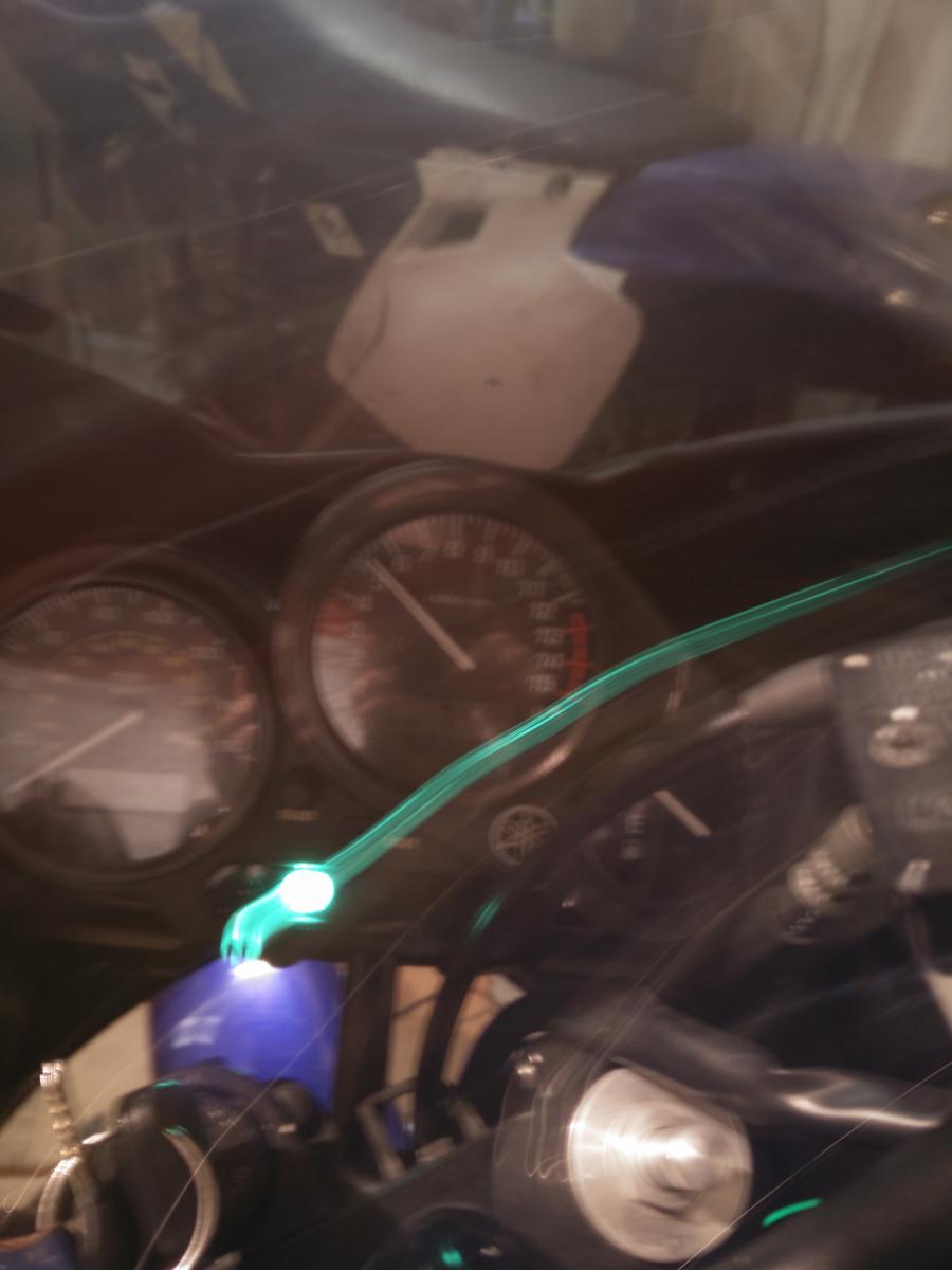

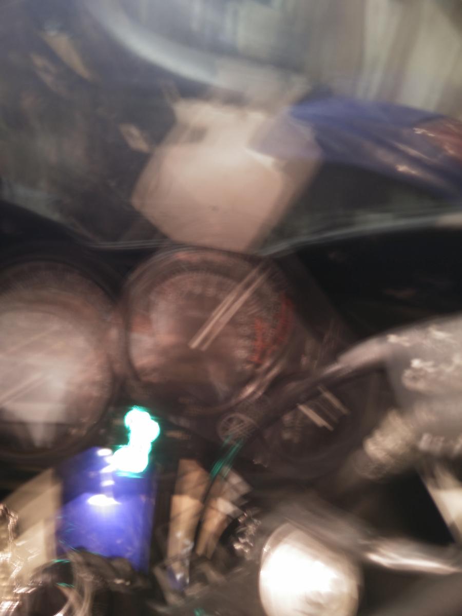

Re: running lumpy - CaptainCazador - 22-01-17 OP If you've recently bought the bike a full service wouldn't be a bad idea. Soak the plugs though with some penetrating fluid at least a few days prior to extraction and if one feels particularly tight there's only one way it's coming out and that's in two halves. Re: running lumpy - darrenc - 22-01-17 OK so I'm working through shit within my technical capabilities so in the realms of this going to the garage soon I thought I will at least take a look at the TPS, being as I haven't had much luck so far I was full expecting a 3000 reading, much to my relief I got a 10000, pheeeeeew. So I have at least managed to sort that focking problem myself. As per usual pics attached albeit shit ones but they shiw the 10000 and 5000 readings just about
Re: running lumpy - bandit - 22-01-17 Change the plugs first or do as said previously switch two plugs around to see if a different downpipe remains cooler. Re: running lumpy - darrsi - 23-01-17 Were you sitting on a spinning washing machine when you took those photos? :lol Re: running lumpy - BBROWN1664 - 23-01-17 The TPS check wont show 3K. Where did you get that number from? It's either 0, 5 or 10K. Re: running lumpy - darrsi - 23-01-17 (23-01-17, 02:37 PM)BBROWN1664 link Wrote: The TPS check wont show 3K. Where did you get that number from? Think he meant he was "expecting" a 3K reading, as in faulty, because of his luck so far. Re: running lumpy - darrenc - 23-01-17 I read somewhere if it read 3k it was a TPS fault?? not sure where, i hear 0 and 10k meant it needed adjusting and 5k was ok. As for the photos they are shocking, not sure what was going on there hahah. Re: running lumpy - Fazerider - 23-01-17 (23-01-17, 03:32 PM)darrenc link Wrote: ... As for the photos they are shocking, not sure what was going on there hahah.Not enough light. Nobody can hand-hold a camera steady for a 6 second exposure. Anyway, back to the bike... why not try the easy things first? Adjusting the TPS is a good thing to do once you've sorted the problem out but it was never going to be the cause of it. 1. Trim the HT leads. 2. If that doesn't work try swapping the plug caps (JUST the caps) between plugs 1 and 4, if the fault moves to Cylinder 4 then get some straight NGK replacements. 3. Try a new plug 4. Get the carbs off and clean them. 5. Reset the idle and adjust the TPS. Re: running lumpy - BBROWN1664 - 23-01-17 before step 4 above, try balancing the carbs. May just be badly adjusted. Re: running lumpy - darrenc - 23-01-17 I don't own a carb tune unfortunately, and I don't want to start cutting stuff (ht leads etc) in case I make a complete hash of it. I'm going to take it to a local garage tomorrow who I have used multiple times before so trust them. What I will do is say it may simply be a dud plug or lead cap, if it isn't either of those its likely to be something carb related such as blocked jet etc. If it is carb related I might ask them to clean the carbs out and balance for me at same time I need this focking bike running sweet as a but for two weeks time as it will then become my only means of transport for my daily commute in my new job. If the garage can't sort it then I may need to call upon my experienced foccers to wither come to my aid in West Yorkshire or I can ride to someone as long as it isn't too far away and compensate via means of beer, pub lunch out and beer or good old cash and I will hopefully learn a thing or two in the process as well
