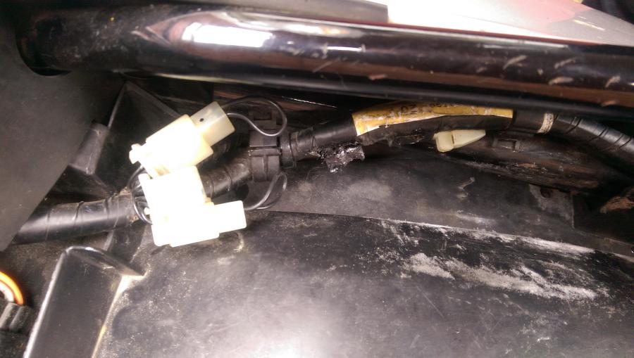

Loop plugs as I found them. They all seem secure. Put the battery back on the optimiser as it showed up as needing a top up I think I'll buy a batter just as a matter of course now.

If the ignition fuse blew I'd be checking around the headstock/ignition switch area for a broken wire that managed to make contact with something earthed. The parts of the wiring harness that get flexed regularly are the most likely places to get trouble, but it's also worth checking anywhere it can get pinched.

Had a look around the ignition cable and found this... (see photo) so I'm going to re connect it while the new battery arrives (any recommendations?
Re: Complete lack of start up. - slappy - 21-11-16
Strip both ends back about 3/8" then solder together and cover it with heat shrink, don't forget to slip the heat shrink over one of the wires first.
I would check all the other wires there for damage as well and see if you could  move the wires enough to stop them getting chafed again in the future,

(21-11-16, 03:30 PM)DangerNoodle link Wrote: Had a look around the ignition cable and found this... (see photo) so I'm going to re connect it while the new battery arrives (any recommendations?
That would be your problem and why the fuse blew. Looks like its been pinched  due to poor routing rather than chaffing since it looks more like a cut.
With limited tools the Solder tube is probably your easiest option and permanent. Take care to route it properly when complete.
Is it the cable to the switch gear or the Ignition switch difficult to tell from the picture?

Just splicing the wires together will put a rigid section where the loom flexes with the steering which will possibly end up with the same problem again unless the loom can be rerouted so it flexes on another section away from the repair.
Alternatively replace a longer length of the broken wire so it's a bit of new wire that is doing the bending but this means two splices instead of one.
