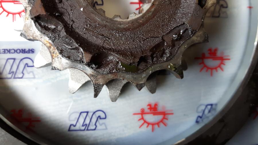

Re: front sprocket nut - chrischristopherson1313 - 29-04-16
(27-04-16, 11:39 PM)sinto link Wrote: [quote author=tommyardin link=topic=19958.msg230556#msg230556 date=1461792717]
FFS Sinto I think you were lucky that the chain had not jumped the sprocket and wiped out the clutch push rod assembly.  :eek :fish
I know!
I kept putting it off due to one thing or another, knew it needed done but came end of last season I put it away and one thing led to another, wirk/family issues etc but yes, I'm extremely lucky so it's a lottery ticket at weekend me thinks Smile
Ok so all done new sprocket and nut on placeSmile
The picture of old sprockets and that small nut attached
[img]http://[smg id=2794 type=preview align=center caption="tmp 5921 20160429 1829002038478561"][/img]

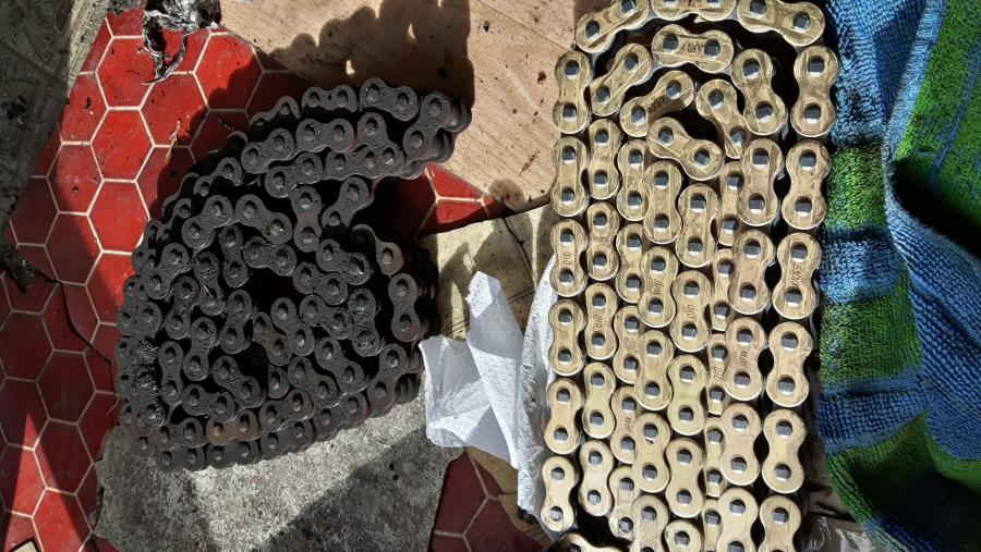

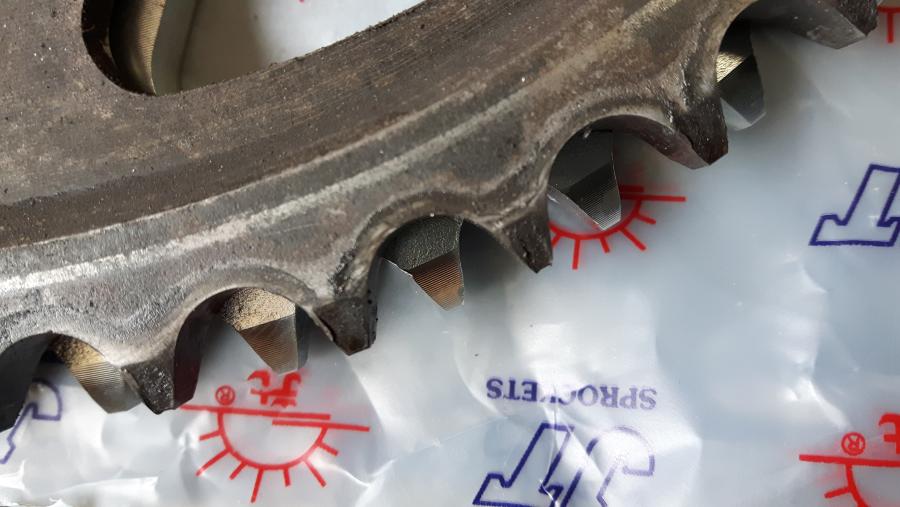

[smg id=2798 type=preview align=center caption="tmp 5921 20160429 182907249810580"]
(29-04-16, 11:43 PM)chrischristopherson1313 link Wrote: [quote author=sinto link=topic=19958.msg230561#msg230561 date=1461796780]
I know!
Re: front sprocket nut - chrischristopherson1313 - 30-04-16
[smg id=2800 type=preview align=center caption="tmp 5921 20160429 1829291866326807"]
(29-04-16, 11:59 PM)chrischristopherson1313 link Wrote: [smg id=2798 type=preview align=center caption="tmp 5921 20160429 182907249810580"][quote author=chrischristopherson1313 link=topic=19958.msg230803#msg230803 date=1461969837]
I know!
Re: front sprocket nut - Val - 30-04-16
Good job that you have changed the nut  :thumbup
Two questions. I see on the pictures the rear wheel is almost at the end of the stretching the chain? Not sure from the picture is that the case.
Do you have enough chain slack, it must be 30-40mm. Do you have measured your chain wear? 10 links must be no more than 150mm long. If it is more the chain has been stretched too far and needs change.
(30-04-16, 08:53 AM)Val link Wrote: Good job that you have changed the nut  :thumbup
Chain slack its ok
IT'S still 2 lines to limit. It's better when I changed sprockets.
I will check that 150mm when have time.
Thanks
Re: front sprocket nut - His Dudeness - 30-04-16
Might just be the picture but do the threads on that shaft look stripped to anyone? I'd be keeping a close eye on that I think they look pretty worn
Re: front sprocket nut - darrsi - 30-04-16
(30-04-16, 01:37 PM)His Dudeness link Wrote: Might just be the picture but do the threads on that shaft look stripped to anyone? I'd be keeping a close eye on that I think they look pretty worn
What threads?  :look
