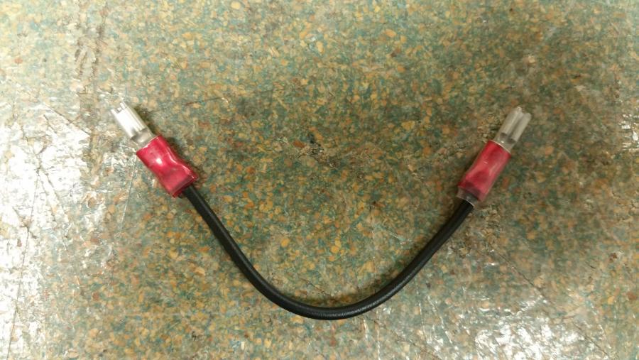

Re: Side Stand Switch - unfazed - 26-02-16 The visible screws in the picture are not for removing the switch, they are part of a set of 4 for keeping the sealing plate and wire guide in place. 2 pan head screws hold the switch to the frame and can only be accessed from underneath and are loctited in place. Ensure you have a good fitting philips screwdriver but there is a good chance they will be wrecked on the way out. Use an impact screwdriver to remove as it will fit cleanly and replace then with normal bolts or allen bolts and loctite them back in place. If switch falls off when riding the engine will stop dead. Re: Side Stand Switch - fazersharp - 26-02-16 I knew there was a reason why I didn't remove it when I was cleaning the area - Yamaha cheese screws Re: Side Stand Switch - darrsi - 26-02-16 (26-02-16, 12:44 AM)unfazed link Wrote: The visible screws in the picture are not for removing the switch, they are part of a set of 4 for keeping the sealing plate and wire guide in place. Don't s'pose you would have any idea of what size and length of bolts needed perchance, as i'll try and get some replacements from work later on today? I've got another week off work from Monday so i'll need to have the bolts to hand at home. Re: Side Stand Switch - unfazed - 26-02-16 Just saw this now Darrsi, I think they are around the 16mm mark, but not 100%sure Re: Side Stand Switch - darrsi - 26-02-16 (26-02-16, 07:36 PM)unfazed link Wrote: Just saw this now Darrsi, I think they are around the 16mm mark, but not 100%sure It's okay, this is the first chance i've had to check too, i've had a manic day! Re: Side Stand Switch - darrsi - 24-03-16 I've not got round to doing this yet as I've had a dodgy back, but was hoping to try and change it tomorrow for the replacement one I bought. Only thing is, the more I look at it, it just seems to be in a complete bastard of a place to actually get near it, to whack the screws with an impact driver for instance. ![]() Am I missing a simple trick or something, or is it really just in a nasty position with the exhaust in the way as well? Re: Side Stand Switch - unfazed - 24-03-16 Best of luck :'( Re: Side Stand Switch - His Dudeness - 24-03-16 If it cuts out and leaves you stranded anywhere disconnect the switch from the loom and bridge the connector with a bit of wire and you'll be on your way ![]() Re: Side Stand Switch - darrsi - 25-03-16 (24-03-16, 10:44 PM)unfazed link Wrote: Best of luck :'( When i hear things like that from you, i know i'm in trouble. :look After i got home from work yesterday i got a new can of brake cleaner out and thought i'd degrease it while it was raining in the hope the rain would dilute the mess i was gonna make. I probably should put it on the centre stand, although i dunno how much that would've helped either, but i could barely even get close to it to spray the chain lube off. Whoever has the job of fitting them either has first go on an upside down empty frame, or is standing in a pit. :groan Re: Side Stand Switch - darrsi - 25-03-16 (24-03-16, 11:26 PM)His Dudeness link Wrote: If it cuts out and leaves you stranded anywhere disconnect the switch from the loom and bridge the connector with a bit of wire and you'll be on your way Yeah, i found a YouTube video on how to basically hotwire it, by either bridging the connector like you say, or even cutting the wire and joining it, which is the same thing. I also read on an old post from years back to just remove the switch and tie it somewhere safe away from the stand, but if i could do that then i'd just put the other one back on. I'll stare at it for a bit longer, and if i come up with something imaginative i'll let you know, otherwise it'll have to go down to the mechanic. :\ Judging by the hole size in the new switch, they are M5 screws, and i've managed to find some stainless cap head screws at work in slightly different lengths to have on hand if i do ever manage to remove it. Re: Side Stand Switch - Jules-C - 25-03-16 The secret is to do what they do in the factory. Take the engine out then you've got good access to change the switch and once that's done put the engine back in the frame! When mine failed I ended up cutting/smashing the old switch to remove it and using allan bolts when putting the new one in since you can't get a screwdriver on the screw heads Re: Side Stand Switch - darrsi - 25-03-16 (25-03-16, 08:01 AM)Jules-C link Wrote: The secret is to do what they do in the factory. Take the engine out then you've got good access to change the switch and once that's done put the engine back in the frame! Yeah, i'm starting to realize that "secret". :'( I've cleaned up the whole area of chain lube so at least i can see it now, and now it just looks like a very unappealing job. I'll stare at it a bit longer then decide what to do next. ![]() Re: Side Stand Switch - darrsi - 10-04-16 Just to let you know, i cleaned up the area of the side stand switch with plenty of brake cleaner, and the scenario now is that i have to start the bike with the side stand up, but once started it does let me put the stand down and remains running okay so i can let the engine warm up without being on the bike. It still won't start with the stand down though, the bastard. Although not ideal, it's a situation that i can more than deal with for now. I still have a new switch at the ready, or a pair of cutters so i can hotwire it if necessary though Re: Side Stand Switch - darrsi - 03-05-16 I know it's not ideal, but to get me out of shit for now I have followed the side stand switch up to behind the left side panel and used a Scotch Lock cable joiner to basically "hotwire" the cables together and bypass the side stand switch for now. I went to unplug the side stand switch plug and found that to be in a stupidly difficult place as well, so this fix will do for now. Re: Side Stand Switch - His Dudeness - 03-05-16 Don't ride off with your sidestand down :lol Re: Side Stand Switch - darrsi - 03-05-16 I'm paranoid about that now, did it many years ago on a KMX, it ain't fun. Re: Side Stand Switch - dublet - 03-05-16 Scotch locks don't insulate well. If you can, just solder it properly. Re: Side Stand Switch - darrsi - 03-05-16 (03-05-16, 09:06 PM)dublet link Wrote: Scotch locks don't insulate well. If you can, just solder it properly. It was a way of trying/testing it out without chopping the wires up for fun. Now i know it works i can consider my next move. Re: Side Stand Switch - His Dudeness - 03-05-16 I'd use a short bit of wire and crimp two spade terminals on either end and connect it into the block connector. Probably not the correct thing to do but it'll work reliably and when you want to replace the switch properly the connector and loom are all still original Re: Side Stand Switch - darrsi - 04-05-16 (03-05-16, 11:03 PM)His Dudeness link Wrote: I'd use a short bit of wire and crimp two spade terminals on either end and connect it into the block connector. Probably not the correct thing to do but it'll work reliably and when you want to replace the switch properly the connector and loom are all still original That was the actual plan, but i couldn't figure out how to get anywhere near the plug, so went in to Plan B. |
