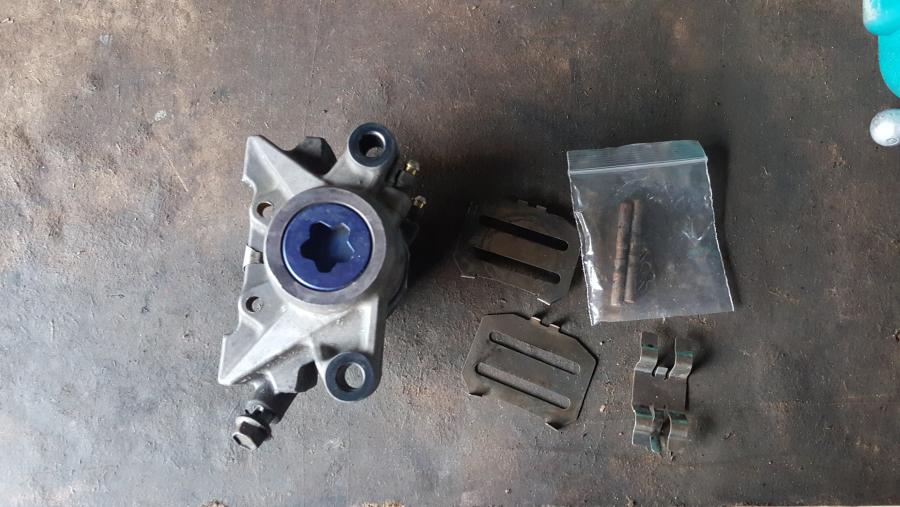

is this rear caliper salvageable? - Printable Version +- Fazer Owners Club - Unofficial (https://foc-u.co.uk/mybb) +-- Forum: Bikes, Hints'n'Tips (https://foc-u.co.uk/mybb/forumdisplay.php?fid=66) +--- Forum: FZS600 Fazer (https://foc-u.co.uk/mybb/forumdisplay.php?fid=78) +--- Thread: is this rear caliper salvageable? (/showthread.php?tid=74578) Pages:
Re: is this rear caliper salvageable? - Deefer666 - 31-12-15 Put the flat shock spanner that comes in the standard tool kit in the middle of the caliper, when the pistons pop out under air pressure they cannot come all the way out that way (30-12-15, 04:49 PM)joebloggs link Wrote: [quote author=Deefer666 link=topic=19013.msg220249#msg220249 date=1451472047] If you've got an air compressor, join your two bits of calipers together again and blow them out ![]() Make sure they're connected or you'll do more than "blow the bloody doors off" :b [/quote] I have a blow gun that I have adapted with a Banjo bolt, so that the body of the gun screws into the caliper. Compressed air normally gets the pistons out. Also I find a bit of heat helps if they are being stubborn... The seals are fucked anyway so a blow torch wouldn't hurt anything so long as you don't go mental and melt the o-ring seal between parts of the caliper. [/quote] I've used a grease gun on the bleed nipple to ease them out in the past, OK so you need to give them a good clean after but I prefer the grease method as you not have pistons flying past your ears when they finally pop free [/quote] Re: is this rear caliper salvageable? - darrsi - 31-12-15 (31-12-15, 10:39 AM)celticdog link Wrote: [quote author=Paulfzs link=topic=19013.msg220168#msg220168 date=1451402995] Plan b it is then! [/quote] That 2nd caliper was £65 not £55, plus would they not sting you for tax as well as it's from the states? Re: is this rear caliper salvageable? - Bretty - 31-12-15 Do you pay import duty on 2ndhand stuff? Anyway UPDATE: I bought a secondhand caliper on ebay and collected it yesterday. It also had knackered seals, but the case was good and it was only £30. Got it home realises it was seized.. FFS! Spent an hour or so faffing about with it trying to get the pistons out. I used the 'new' case and a combination of all the best remaining parts to make one good caliper (minus the dust seals) all cleaned up on the bike and working. I have some new seals on order so when they arrive, unless the existing seals are leaking, I might just fit the dust seals, although the dust seal recess has seen better days! Brett Re: is this rear caliper salvageable? - Jules-C - 01-01-16 They metal at the edge of the dust seals on mine was starting to corrode and the dust seals trying to squeeze out siezing the pistons on mine so rebuilt it without dust seals a couple of years ago as a temporary measure to get it through MOT. Got a eBay caliper to rebuild but it was as bad as my one so never rebuilt it. Had no problems running without dust seals and just clean it once a year Re: is this rear caliper salvageable? - darrsi - 01-01-16 It would appear so! Re: is this rear caliper salvageable? - His Dudeness - 01-01-16 (01-01-16, 01:09 PM)Jules-C link Wrote: They metal at the edge of the dust seals on mine was starting to corrode and the dust seals trying to squeeze out siezing the pistons on mine so rebuilt it without dust seals a couple of years ago as a temporary measure to get it through MOT. Got a eBay caliper to rebuild but it was as bad as my one so never rebuilt it. Had no problems running without dust seals and just clean it once a year Are ya mad? It's your brakes. Get a good caliper. Re: is this rear caliper salvageable? - Deefer666 - 01-01-16 I have in the past (on my own bikes) run a rear brake with no dust seals in but only as a temporary measure. If the main seal is in good condition it is not a problem..... I wouldn't do it on a front brake but on a rear as a stopgap measure its not a problem. Re: is this rear caliper salvageable? - His Dudeness - 01-01-16 (01-01-16, 08:01 PM)Deefer666 link Wrote: I have in the past (on my own bikes) run a rear brake with no dust seals in but only as a temporary measure. If the main seal is in good condition it is not a problem..... I wouldn't do it on a front brake but on a rear as a stopgap measure its not a problem. So have I for a couple of days to get back on the road while waiting for new seals but riding around for a year banananananannas Re: is this rear caliper salvageable? - sinto607276 - 01-01-16 (31-12-15, 10:14 PM)Bretty link Wrote: Do you pay import duty on 2ndhand stuff?This thread http://foc-u.co.uk/index.php/topic,18913.0.html will help you figure it out ![]() Re: is this rear caliper salvageable? - joebloggs - 01-01-16 I hope I'm not tempting fate here but I ordered a pair of discs from the states (second hand) and they tried to deliver them the other day but I was out, I've recieved no bill from the tax man or information on how to pay the dreaded, so I'm hoping it all depends on how the seller packages the items or the value he/she stated the parcel was worth (mine was above the threshold so was expecting to pay before they would deliver) Fingers crossed Re: is this rear caliper salvageable? - darrsi - 02-01-16 A friend of my mum's got sent a text the other day saying she owes £20 tax for a parcel that was delivered to her, with a website address where she could pay the excess. Only thing is, she hadn't ordered anything or received any packages. I checked out the tracking code for her and it all looked legit, and had been signed for by a bloke the previous day. Dunno if someone's made a mistake with her number, or it's deliberate or not. But there are different ways of paying if needed, although i don't know what would happen if you've already received the goods and then don't pay? I had to go to the Post Office and pay the tax before they released an item i bought. They normally send the item back if you don't collect within 3 weeks. Re: is this rear caliper salvageable? - joebloggs - 02-01-16 Had two focin great discs delivered today, looks like they'll stop a truck, no charge yet, and as you said darrsi, I was expecting to pay before they released the items. A pair of Ferodo 320mm discs for £60 delivered from the US, bit of a bargin me thinks Re: is this rear caliper salvageable? - RMT1983 - 06-01-16 got this for sale if any good? need 1 'R' clip and a new plate for it.......... Re: is this rear caliper salvageable? - tommyardin - 07-01-16 If you use an airline to blow out pistons on calipers FFS put a piece of wood between the pistons to stop them flying right out once they make the initial move, what you are creating is an air rifle with two F-----g great pellets, make your eyes water to say the least. lol Re: is this rear caliper salvageable? - joebloggs - 07-01-16 You also need to make sure they both come out at the same time, if ones free its obviously going to pop out before the seized piston Re: is this rear caliper salvageable? - tommyardin - 08-01-16 Good point, then you would be f----- for sure Re: is this rear caliper salvageable? - joebloggs - 08-01-16 (08-01-16, 12:11 AM)tommyardin link Wrote: Good point, then you would be f----- for sure This is why I prefer the grease gun method, far slower, you can see which piston is seized/free or less seized before you pass the point of no return Re: is this rear caliper salvageable? - sinto607276 - 08-01-16 Going back to original post ![]() (29-12-15, 02:43 PM)Bretty link Wrote: My rear brake seizes every winter, but frees up with use. I should have serviced it ages ago, but finally took it off today.You'd be as well just throwing this set in the bin :b |
