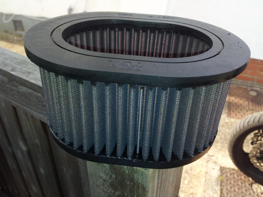

So, finally got round to having a look at the air filter, and I was quite surprised at how dirty it was to be honest.
And when I took it out there was a bit of the old oily mayonnaise in there again.
Cleaned it all out and gave the K&N a good clean up with the recharge kit, then left it on my metal garage flip up door so the sun was shining directly on it to dry it out, then I oiled it.
Not tried the bike yet, I'll know if it's sorted things out on the way to work in the morning.

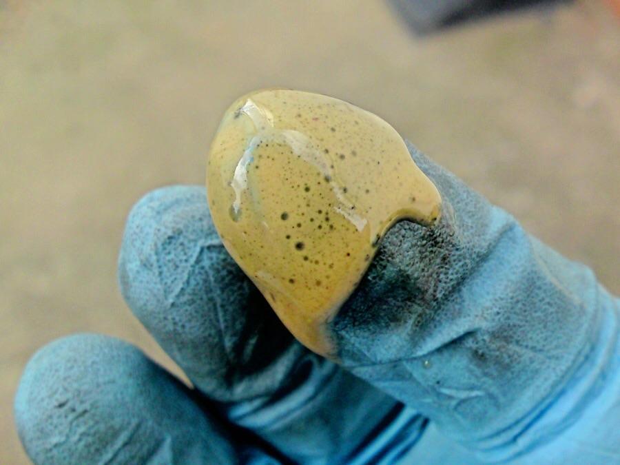

Re: Bit of a weird one - darrsi - 16-06-15
(16-06-15, 08:38 PM)anutz link Wrote: so what is the orange stuff, and why is it coming out of the fuel pipe, its not tango is it?
It's not coming out of the fuel pipe, if it was I would hazard a guess the bike would sound like a bucket of nuts and bolts.
I believe it's a mixture of moisture and oil that collects over time at the bottom of the air box.
This time wasn't too bad, when I first got the bike it was swimming in the stuff when I opened up the air box.

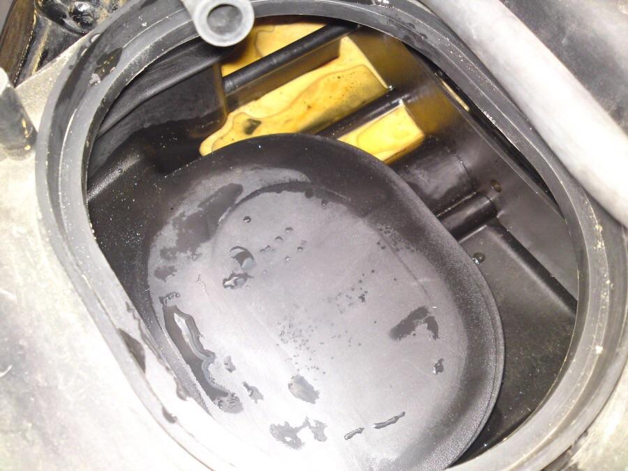

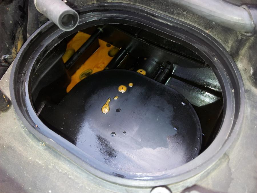

These photo's were taken when I first got the bike.
Re: Bit of a weird one - Yas1 - 16-06-15
That gunk looks like an oil+water emulsion. Are you sure it's not coming out of the crankcase breather? Have you changed the oil recently, was that OK?
Oil's recent and fine.
Last photos are seven years old.

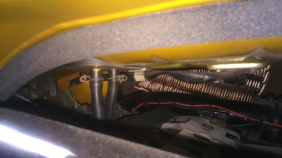

Re: Bit of a weird one - paulchucky - 17-06-15
i`ll get a photo later
but you`ll have to tell how to upload it
never works when i try ??
(17-06-15, 04:23 PM)darrsi link Wrote: When you've got your photo online, or on your phone, choose "Additional Options" underneath the box for writing in when you reply, then browse for your photo.
You do have to have something written as well, even if it's just a full stop.
Press "(more attachments)" if you want to send more than one photo. (up to 4 per post)  :thumbup
pipes
