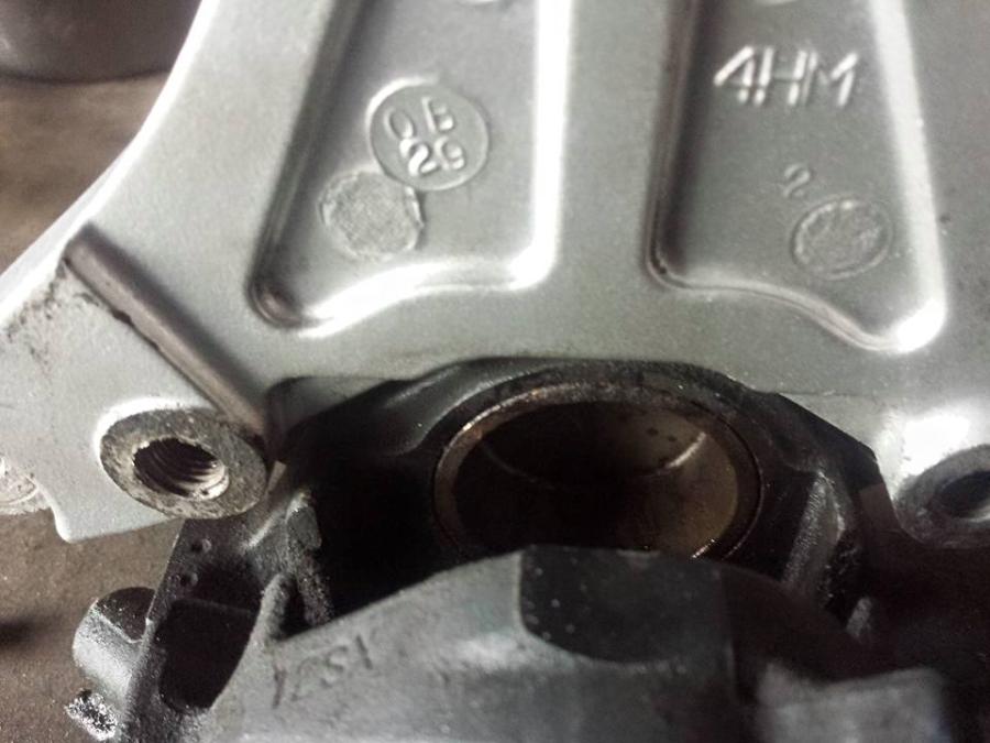

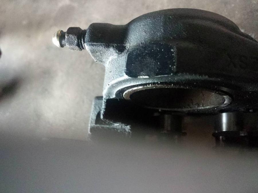

Re: Fitting FZ1000 Caliper to FZS600 - anutz - 02-06-15
so been at the caliper with a file and a little wet and dry, just took the lips off and its nice and smooth now, old pads seem to fit ok with not a shocking ammount of play, waiting for new ones to arrive...

Re: Fitting FZ1000 Caliper to FZS600 - sinto607276 - 02-06-15
Nearly look as clean and smooth as your office hands anutz Wink
Well done mate Smile
Re: Fitting FZ1000 Caliper to FZS600 - unfazed - 02-06-15
(02-06-15, 10:24 PM)sinto link Wrote: Nearly look as clean and smooth as your office hands anutz Wink
:agree
