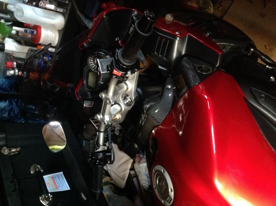

Just sicking thos pic in for my reference of what ive got currently.
Whole bars, risers and associated gubbings looks lacklustre.

I think I can see your handling problem  :lol
Re: Sprucing up the old FZ1 - noggythenog - 01-02-15
(01-02-15, 06:26 PM)nick crisp link Wrote: I think I can see your handling problem  :lol
Chronic sidewaysonitis Nick Smile
Like haggis vision........their eyes have this view to counter one leg being shorter than the other which in turn helps them run round hills.
