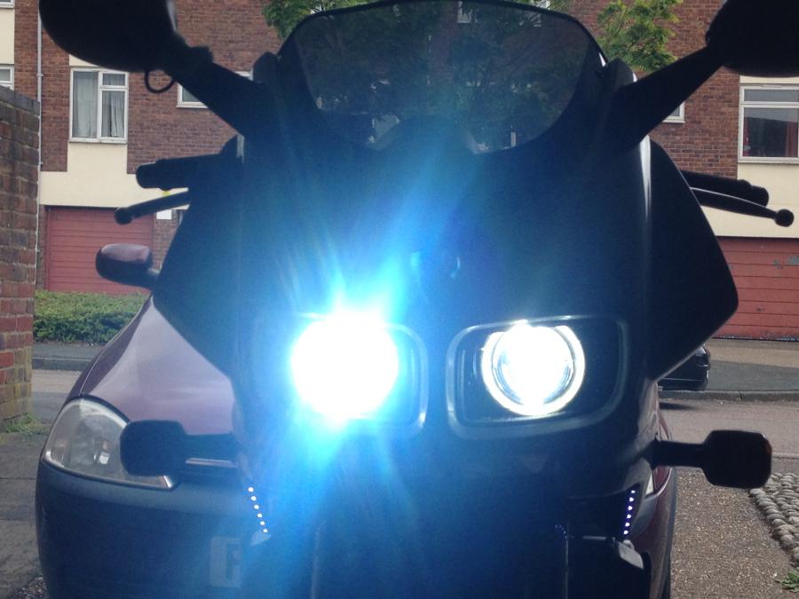

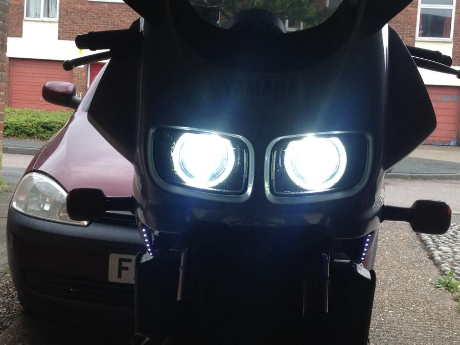

Re: The great/rubbish light debacle... - davidkent - 02-04-14 (20-03-14, 08:02 PM)midden link Wrote: It's my understanding that Jehovas refuse blood transfusions on the belief they will take on the personality of the donor. I hate to take on the personality of a BMW driver :evil I drive a 3 series and ride a foxeye 600, what does this make me? Lol Re: The great/rubbish light debacle... - dcurzon - 23-04-14 Update - parcel arrived, complete with loads of loom. I'm going to have to try to make head/tails of the wiring... 12v for the angel eyes will come off the sidelight. 12v from the battery to the ballasts Light wiring to trip the relay for lights on/off High beam wiring to trip the hi/low Shouldnt be too much trouble if i'm honest. Other than not much room to move in the garage and trying to find some time. I'll probably wire them up 'off the bike' initially. Re: The great/rubbish light debacle... - davidkent - 23-04-14 Get on it and get some pics up

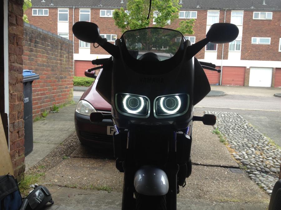

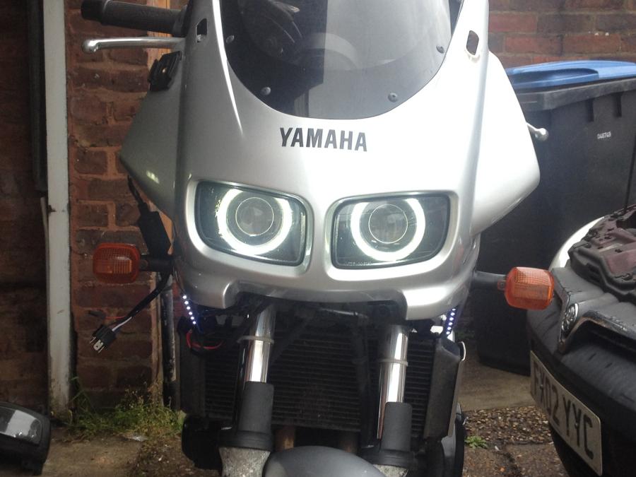

Re: The great/rubbish light debacle... - dcurzon - 23-04-14 Fairing off, headlights fitted, tested all 'off bike' I'm indecided wether to use their loom or not. Advantage - it runs straight from battery and will use the stock connector just for tripping the relay = good clean power. Disadvantage - theres a lot of loom! It's well made though. I think I'll keep their loom in the drawer and just hook up from stock connectors. We'll see, time isn't an issue Re: The great/rubbish light debacle... - MarkWales - 24-04-14 These look really good - cannot wait to see them in action Re: The great/rubbish light debacle... - JoeRock - 24-04-14 (23-04-14, 11:09 PM)dcurzon link Wrote: Fairing off, headlights fitted, tested all 'off bike' Re: The great/rubbish light debacle... - JoeRock - 24-04-14 To be honest mate, with how old the headlight wiring will be now, I'd probably bypass it and go straight to the battery for the best power possible. That said, I'm pretty certain the draw from HID's is actually lower than the standard headlight bulbs, so you might well be okay. Or, if time really isn't an issue, rewrap the loom, taking out the old headlight wires? Re: The great/rubbish light debacle... - dcurzon - 24-04-14 Fairing and light unit fitted more or less, still got the bits that the mirrors bolt onto to fit. Angel's both wired up I'm going to use the rhs for tripping the hi/lo, for now I've just pushed the wires into the h4 socket, I need to get a couple of h4 male's, 1 for the hrs for hi/lo, and the other for connecting the lhs to the relay. Late night and a flat battery stops play Re: The great/rubbish light debacle... - dcurzon - 26-04-14 Jump started from the car, still only temporarily wired up as swmbo is whining about time I'm spending in the garage... About 1.5hours this week... Re: The great/rubbish light debacle... - dcurzon - 26-04-14 Jump started from the car, still only temporarily wired up as swmbo is whining about time I'm spending in the garage... About 1.5hours this week... Re: The great/rubbish light debacle... - dcurzon - 27-04-14 Time actually worked out to not be on my side, with a tube strike and a few issues at home to contend with. So I'm going to order some 2way amp connectors and sort the wiring out another time, should be a doddle but would rather wait until I have the connectors that I want. So I've wired thus: Both halos Left light dipped beam Right light dipped and full beam I'll take some night time shots against a garage door later Re: The great/rubbish light debacle... - Sannox - 27-04-14 Arrrggghh, I'm blind! Nice work, thought about getting this done on my foxeye Re: The great/rubbish light debacle... - davidkent - 27-04-14 (27-04-14, 02:26 PM)Sannox link Wrote: Arrrggghh, I'm blind! Nice work, thought about getting this done on my foxeye Me too, looks costly though Re: The great/rubbish light debacle... - dcurzon - 27-04-14 They're complete kit for the z750/z1000 is 215€ that's everything - 2yr warranty, bulbs, ballasts, looms, modified plate etc, so I'd expect it to be a similar ball park. I won't disclose what I paid, but I already had bulbs and ballasts anyway http://www.retrofitlab.com/retroquick-kits/kawasaki-z1000-z750-mh1-1.html Re: The great/rubbish light debacle... - apage16 - 27-04-14 How did you get the flash/pass button to work? I wired mine up so the main beam flipped the solenoid as you did, but this just resulted in a 'click' from the solenoid if the headlights weren't switched on already. Moot point for me really, as I'm going back to standard. Stupid EU rules. Auxiliary driving lights, here I come! |
