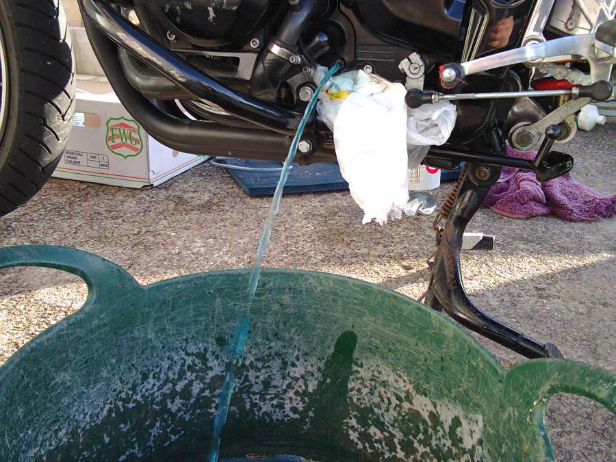

Re: Changing my coolant - any last tips - fazersharp - 12-11-13 Ok done it. A few notes - the on line pdf manual says that the total amount of coolant is 1.95 and the reservoir has a o.61 capacity = 1.34 in the rad an other bits I think that the reservoir capacity must be the total volume as I put in 250ml from empty to the max line which would mean ther is an extra 360ml of space - but looking at the tank I dont feel there is not that space left. I had 2ltrs of ready mixed coolant and put 250 in the res and I have 450 left over in the bottle which means I put in 1.3ltr in the rad filler neck which gives a total system capacity of 1,550 ml - now add that 360ml that the pdf says the res holds extra over the 250 I put in then you get 1,910ml which leaves an extra 85ml for system areas that draining dosent drain. So the upshot is I have 450ml left over from 2ltr after fill the res to the max line is that right. A thing I did was to put the drain plug in at only hand tight during the radflush so (in my mind ) to keep some crush-ability left in the washer for the proper fill. Here is some fazer pissing photos inspired by redhunter. OH and by the way that 2 year life blue stuff has been in about 10years And the max fill line pink new stuff with the extra space Re: Changing my coolant - any last tips - darrsi - 12-11-13 As long as it's filled up to the radiator cap, and also the level in the expansion tank, then all is good, don't worry about measurements! Occasionally having a look at the expansion tank level when the bike is cold can tell you whether the system is healthy or not. Basically that level should hardly ever change if all is well, you MAY have to give it a tiny top up occasionally but that could be months apart if the system is clean, airtight and flowing properly, and any top up should be minimal. If you get overflowing from the expansion tank (whilst boiling), you notice it's low or empty, or the fan unusually starts kicking in (quite rare) then you need to investigate, which will probably just be scaled up waterways, and then you're back to the Radflush again. I've always been a fan of leaving Radflush in for a couple of days so that the engine heats up and cools down a few times, but you need mild weather, not too hot or cold for obvious reasons, and you wouldn't want to do any long runs on the bike either. Re: Changing my coolant - any last tips - fazersharp - 12-11-13 Ok cheers!! That reminds me I left it running with radflush for at least 15 mins- mabe 20 and still the fan didnt come on. so I gave up. If the fan isnt working should I be worried The fan has never come on in normal riding but I dont sit in traffic either. Re: Changing my coolant - any last tips - darrsi - 12-11-13 (12-11-13, 11:26 PM)fazersharp link Wrote: Ok cheers!! I've heard mine come on a few times in hot weather when sitting still, but there are many on this forum who have never ever heard theirs kick in before! They tend to cope with heat quite well. The fan on my previous bike was much more sensitive and would kick in all the time, but that's what they're meant to do so it's no big deal, unless your system is clogged up, then it "may" come on more often, but more than likely it'll just dump coolant out of the overflow pipe on the expansion tank. Re: Changing my coolant - any last tips - fazersharp - 12-11-13 Ive often thought that a rad cover would reduce the air to the rad (I dont have one) Re: Changing my coolant - any last tips - darrsi - 12-11-13 (12-11-13, 11:41 PM)fazersharp link Wrote: Ive often thought that a rad cover would reduce the air to the rad (I dont have one) I've got one, never had any issues. Re: Changing my coolant - any last tips - fazersharp - 12-11-13 (12-11-13, 11:48 PM)darrsi link Wrote: [quote author=fazersharp link=topic=10671.msg112938#msg112938 date=1384296099] I've got one, never had any issues. [/quote] Not an issue but (12-11-13, 11:36 PM)darrsi link Wrote: I've heard mine come on a few times By the way not trying to have a dig ---thank you for your help and wisdom I would have a guess that the only people to have had the fan come on while riding are those with a rad cover ??  |
