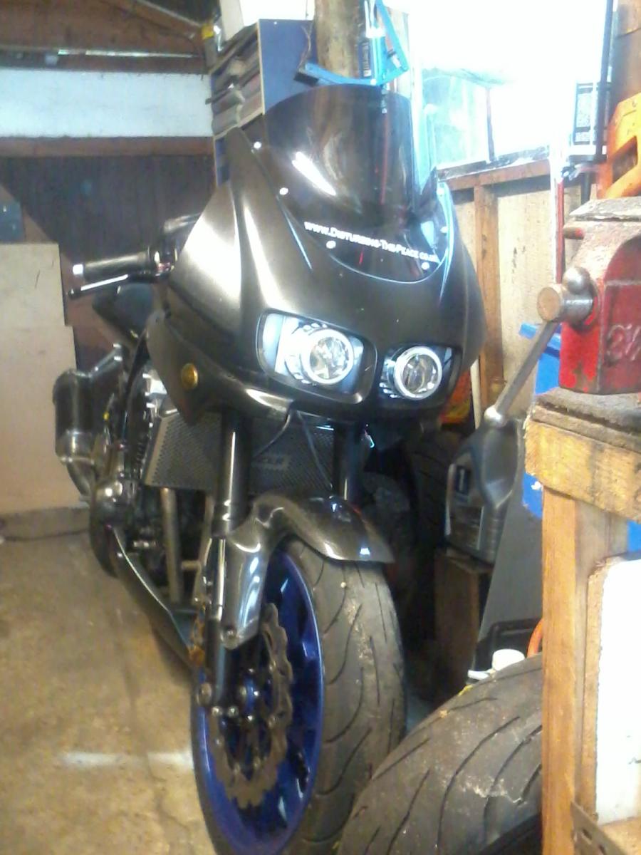

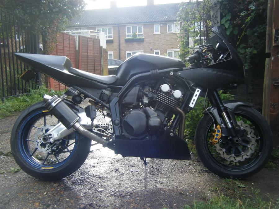

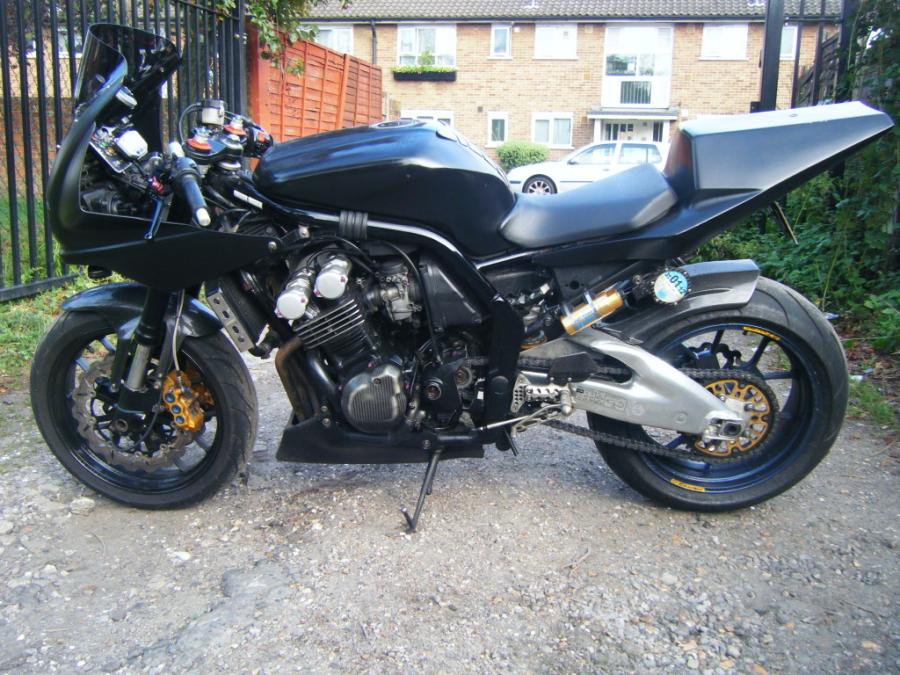

Re: FZS600gRR unreleased model - ChristoT - 18-09-13 See, he's nearly there! :lol Re: FZS600gRR unreleased model - wraith600 - 19-09-13 ok hear goes had the bike since reliese in 98 tried all the fork mods but none done what i wanted so . suspension front . 2000 rsv mille forks / yokes with a new stem , rsvr magnesium wheel , glaffer disks , KAD 6pot billet calipers . clipons , 2003 R1 master cylinder and clutch leaver mount with adjustable leavers .carbon fiber mud gard rear 2000 rsv mille swingarm with moded linkige mount ,rsvr magnisium wheel , glaffer disk , supersprox sprocket , Ohlins remote res rear shock , carbon fiber hugger 120/70 ,190/55 tyres frame 2002 R1 rear subframe with Harris bodywork and a combined rear light exhaust hanger is a modded stock R1 item . fairing , sides have been shaved on the top for clearence with the bars indicator and mirror holes fiber glassed up with a little extra in side to brace it [internal braces removed ] new fairing mounts made from 4mm ally sheet pushing it 60mm forward and 40mm lower twin HID projector headlights ,double bubble screen ,vapor speedo ,gilles rear sets [no center stand ] engine stock . micron exhaust with a shortend [240mm] performance parts can and home made baffle ,[ to be modded again soon ] modded airbox with K&N filter , dinojeted carbs , nicko G pack, Kevlar clutch plats and heavy duty springs , 0/40 oil [ no i have never had issues] also have extralube and a magnetic oil filter spacer and K&N oilfilter , modded sprocket cover ,10mm off set sprocket and extended clutch pushrod ,525 chain carbon/Kevlar generator & starter crash covers . power/weight aprox 93bhp and 180kg [wet] to do finish dash [again] the vapor is ok but the rev counter on it is useless,mod the original micron end can and put it back on also mod the pipe from the collector to midpipe rejet and dino again fill in the holes around the new head lights and respray all the bodywork. looking at various engine tuning options at the moment N/A ,nitros and turbo . would like to get it to about 120bhp some one did get a turbo to 140 but then trashed the engine all this has been done over the period i have had the bike not all at once . Re: FZS600gRR unreleased model - noggythenog - 19-09-13 Foooooooooociiiiin elllllllll!!!!!!! :eek , thats some amount of tasty mods buddy.....do you take pills for that :lol Fair play to you likes that's one original bike. I dont feel so guilty about my couple of cheap bolt on mods now. How does it ride?,does it go how you expected, i mean even the standard fazer goes well so what bikes you given a surprise out on the road? 8) Re: FZS600gRR unreleased model - simonm - 19-09-13 Please can we have more pics wraith? Re: FZS600gRR unreleased model - Ruby Racing - 19-09-13 (19-09-13, 07:17 AM)wraith600 link Wrote: rear 2000 rsv mille swingarm with moded linkige mount ,rsvr magnisium wheel , glaffer disk , Hope I'm not thread jacking here and wonder if you could help me out. I'm planning on a 180 rear tyre on a different swing arm for my build. Did you have any issues with getting the rear wheel centre in relation to keeping the chain run straight? Did the front sprocket need spacing outwards or any other kind of mods to line it all up? Are the Gilles rear sets specifically for the FZS600, or for another model? Thanks. Re: FZS600gRR unreleased model - Motorbreath - 19-09-13 Do it, add a nitro or a turbo! Re: FZS600gRR unreleased model - simonm - 19-09-13 If you were to turbo it where would the subsequent weakest links be? Would it be the radiator? I know nothing about engines but am curious what bits would be in spec and which wouldn't and therefore how much of an impact it would have on the design of the rest of the bike mods and the subsequent cost. Re: FZS600gRR unreleased model - nick crisp - 19-09-13 Just some thoughts: A turbo would require flat-topped, forged pistons to drop the measured compression ratio. It would be wise to also do a number of engine-strengthening mods : Shot-peen, or better still, replace rods with Carillo or similar. Are the cranks pressed? If so, weld. Heavy duty valve springs. Heavy duty clutch - not sure what would be best type. Adjustable waste-gate and know what you can set it to, and how to do it by degrees until you reach what you're happy with/won't blow the motor. It may also require some attention to strengthen the gearbox, but I have no idea what you could do in this regard. It's possible that a supercharger could be a better idea, so worth looking into. Nitrous to me seems a pain, as you're always going to be needing top-ups if you use it much, whereas a turbo or supercharger is always just there. It's not going to be the most common of bikes chosen for these kinds of mods, so don't know what the availability of such parts would be? Back in the day, people also did "conventional" tuning: hairy cams, big bore kits, smoothbore or flat-slide carbs, porting and gas-flowing. It's generally agreed that such engines were pigs for road use - won't idle, snatchy and bog down until you get them on cam, etc. However, there were some notable tuners who could do a half decent job of it, John Carpenter of Mistral fame is the only one I can think of. I wonder if modern parts and techniques have improved matters in more recent years? It seems almost a shame to have all that beautiful chassis work done and then a have a near stock motor, so you've gotta do something to pep the engine up a little! Dare you tell how much it has cost so far? :eek Re: FZS600gRR unreleased model - Doddsie - 19-09-13 I like the front mudguard..... its shiney!!!!!

Re: FZS600gRR unreleased model - nick crisp - 19-09-13 (19-09-13, 07:18 PM)Doddsie link Wrote: I like the front mudguard..... its shiney!!!!! You need help... Re: FZS600gRR unreleased model - wraith600 - 19-09-13 the Gilles rear sets are specifically for the FZS600, luckley the mille wheel has 10mm more offset than on the fazer but its not a straight swap as you will need a new swing arm as the stock will not take anything wider as far as i know ,the linkage mounts on the mille arm also need modifying as well as the frame as the arm is wider there are 2 spacers on the inside of the frame that need trimming down also the gear box sprocket cover needs moddifing for chain clearance most of my pix are on photobucket just follow the link , i have not as yet uploaded the latest for the new head lights [size=78%]http://s1124.photobucket.com/user/wraith600/library/?sort=6&page=1[/size] |
