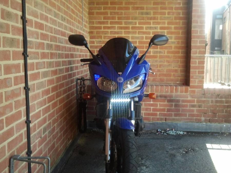

Re: Blue side lights, legal? Discuss... - chunk166 - 24-08-13 Hi,I think it stands out quite well,I have stood about 100 mtrs away & it still looks bright but if you do fit them you might need to angle it slightly upwards so on coming traffic see it better,but don't but cheap crap as they don't last? Here is another pic taken further back from the last pic. Re: Blue side lights, legal? Discuss... - nick crisp - 24-08-13 They look pretty bright, how have you mounted them? Re: Blue side lights, legal? Discuss... - chunk166 - 24-08-13 I tried using number plate sticky pads but they didn't work so i used 2 self tapping screws & as its underneath the fairing it wont show any holes if you take it off,they are connected to the left sidelight connector block,all i did was strip a little of the plastic off the ends & put it in the block before reconnecting it
