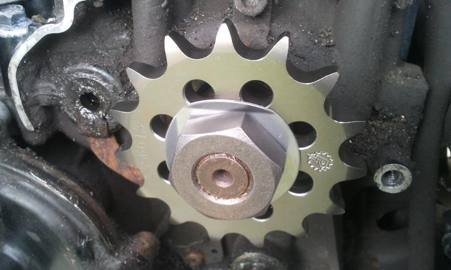

(20-08-13, 11:59 AM)BluprintZ link Wrote: Just got the nut and tab washer, obviously it's the 12mm one but as in the pic above of the old 9mm one, there's a shoulder of about 3mm which i assume locates on the plastic bit on the original Yam sprocket, to quieten things down i believe?
So, my question to those of you who have had to replace the old nut with the new one, what do you consider the best torque setting, after of course adding threadlock to the shaft threads?
I would rather take advice from someone who has done this than rely on the Haynes book of lies, to be honest.
G ; )
From memory i think the old one was 70Nm and the new one was a suggested 90Nm, but i personally had mine torqued at 80Nm.
Re: Nuts, chains and sprockets. - Dead Eye - 20-08-13
Pretty sure I put mine on at 90Nm after reading about the recommended upgrade - but then again I didn't use any threadlock
Haven't had any issues in the 4k miles I've done
Re: Nuts, chains and sprockets. - BluprintZ - 20-08-13
Ok guys, cheers for the info, i'll be gritting my teeth as i tighten it up, the shaft threads didn't look too clever really!
G ; )
Right then, the nut and tab-washer are fitted.....although, i took it to 70Nm and the torque wrench was clicking away.
The tab-washer and the sprocket were still very loose, so i took it to 90Nm and again, clickety click and the washer etc, were still rather loose.
So i thought sod it, keep going until the washer and sprocket were waggle free, which i did and folded the tab over and put everything back together again.
I'm assuming that the sprocket isn't supposed to be loose?, i'm thinking that the reason the torque wrench was clicking, was because the nut was threading the slightly damaged shaft and it was reaching the specified Nm due to this?
Oh well, time will tell i expect, i put threadlock on the shaft, it's got new chain and sprockets fitted, plus of course the new nut and washer, we'll see how things go.
It's gonna be a nervous ride, the next time i take her out.
G ; )
Re: Nuts, chains and sprockets. - darrsi - 20-08-13
(20-08-13, 06:19 PM)BluprintZ link Wrote: Right then, the nut and tab-washer are fitted.....although, i took it to 70Nm and the torque wrench was clicking away.
G ; )
Still loose at 90Nm ?
Oooerr......  :look
Re: Nuts, chains and sprockets. - freeware - 20-08-13
I've done my 'chain/sprocket/12mm nut' over 2 weeks ago.
- Torqued at 80 Nm.
- No thread lock but copper grease.
- No play on the sprocket.
Done about 400 miles since then and it seems fine so far. Also replaced the gasket.
Nut/washer from Yam dealer for 2.44, and gasket for 3.66 delivered within two days.
Re: Nuts, chains and sprockets. - nick crisp - 20-08-13
Ok, I gotta say it - you're o/p shaft thread doesn't look good to me in the photo BlueprintZ...
Gotta agree with you Nick, and also a tad worrying the nut had to be done up so tightly as well.
@freeware, i'm a big fan of copper grease, i use it a lot on my bike, but i'm surprised you used it on the front sprocket nut, i think i would rather prefer it seized on!
If it were me, my first port of call would be to a good engineer to see if it could be built up with some kind of weld or something, then recut the thread, preferably with everything in situ. Maybe there's someone on this forum who could answer whether or not that's possible.

Re: Nuts, chains and sprockets. - BluprintZ - 21-08-13
I agree the O/S thread looks bad but as i mentioned in my last post, i recon the fact that the torque wrench was clicking at 90 Nm, was probably because the new nut was cutting a thread into the shaft.
I do have access to a very good engineer/welder, although whether to go arc or mig, i will have to discuss with him.
To be honest, now that i have a new chain, sprockets and the 12mm nut on, i'm inclined to let him wend the nut on, as i few on here have done...i think?
I should get a few years out of the bike if i look after the chain but to say i'm rather gutted, is an understatement, i really was happy with the bike, until this shambles unfolded.
It's probably too late to go shouting at Yamaha for a new shaft to be fitted, although i might do, just to see if they will honour the fact that they have messed up with this issus.
Thanks for all the advice guys.
G ; (
Re: Nuts, chains and sprockets. - darrsi - 21-08-13
(21-08-13, 12:09 AM)BluprintZ link Wrote: I agree the O/S thread looks bad but as i mentioned in my last post, i recon the fact that the torque wrench was clicking at 90 Nm, was probably because the new nut was cutting a thread into the shaft.
G ; (
Worth a try at the very least!
When you speak to Yamaha show them the service note number: [size=1em]SERVICE NOTE 2005-12A[/size]
"....Any FZS600 Fazers model (1998-2003), regardless of whether it still in warranty or has been serviced officially in the Dealer channel can be inspected at any official Dealer.  Remove the existing nut and washer. Measure the drive shaft OD of the threaded part (micrometer or vernier caliper). If >= 17.5 mm - clean threads and fit a new washer & nut with threadlock. If < 17.5 mm - the drive shaft must be replaced. (This work could take between 1 day to 2 weeks depending on dealer workload)...."
Re: Nuts, chains and sprockets. - lds1973 - 21-08-13
I'd whip it off and remove sprocket, clean all with wire brush and refit with thread lock, torque to 80 and see how you get on. Or whilst its all off check the nut runs up the shaft.

Re: Nuts, chains and sprockets. - nick crisp - 21-08-13
(21-08-13, 05:40 AM)darrsi link Wrote: [quote author=BluprintZ link=topic=9329.msg95625#msg95625 date=1377040180]
G ; (
Has to be best first option - a new o/p shaft fitted for free? You couldn't turn that down if they'll do it.
2nd option, I'd look at the weld and recut solution - hopefully it could solve the issue on a permanent basis, whereas welding on the sprocket nut maybe will just cause headaches later.
(21-08-13, 10:17 AM)darrsi link Wrote: [quote author=lds1973 link=topic=9329.msg95643#msg95643 date=1377072196]
He's already said it didn't feel tight at 90Nm.
Exactly. Something isn't right hence the need to inspect and clean. I wouldn't be riding around on possible cross threaded/ damaged thread etc etc. Would you?
(21-08-13, 12:33 PM)lds1973 link Wrote: [quote author=darrsi link=topic=9329.msg95654#msg95654 date=1377076648]
Judging by the photo', the shaft thread looks more than ropey to me anyway.
(21-08-13, 01:05 PM)darrsi link Wrote: [quote author=lds1973 link=topic=9329.msg95674#msg95674 date=1377084804]
Its not worth chancing it at all.
Further work required.
