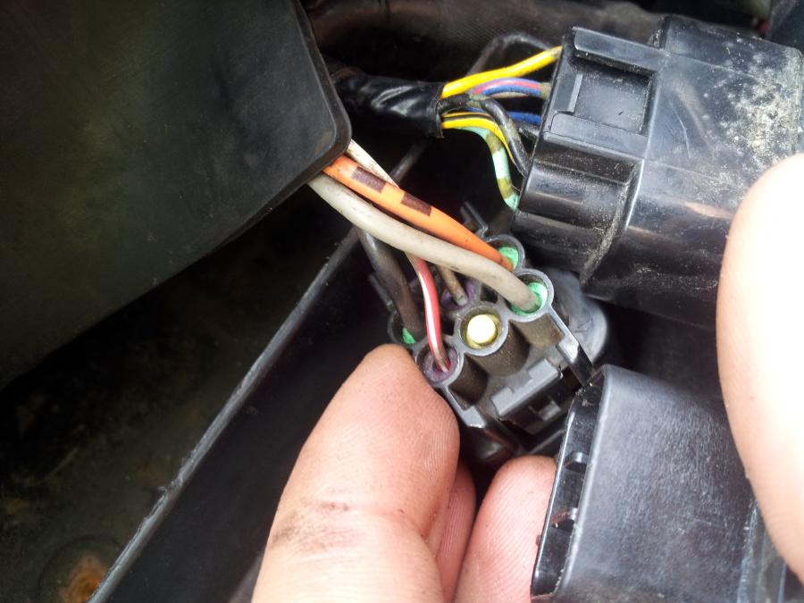

Re: always hard to start - carrier - 08-04-13
hey, could anyone take a look at their CDI/ignistion control unit and see if one of their wires is snipped? Mine has a green wire that is cut off???
according to the wiring diagram there isn't a green wire at all
Re: always hard to start - clayt74 - 08-04-13
Hi carrier, the starter cut off circuit relay, is on the lefthand side of the bike just behind the battery, its the larger of the 2 relays.
as for the green wire on the ignition unit, mine is connected, but as you say im not sure where it connects too?
on the wiring schematic its the wire shown as light green LG which from what i can see enables the starter motor as long as its in neutral or the side stand is up.
doesnt seem to be related to your problem, but i think should definately be connected.
good luck mate
I would definitely get the light green wire spliced back together, it connects from the safety cut off relay so could be preventing the ignition unit exciting the coils properly.  Hence no spark.

Re: always hard to start - carrier - 10-04-13
It was not the ignition control unit/cdi/ecu
Next the starter cut off relay
I took a pic of my CSI and doesn't look the same as clayts
