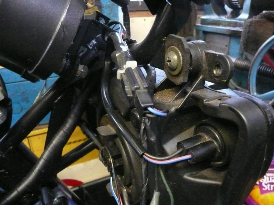

Finally got round to having a look at the other Fazer. Not much to add to what has already been said but a couple of things I noticed.
1) The original left headlight socket, which is no longer used, I left attached to the harness and insulated it with a rubber sleeve and tucked it behind the clocks. You could snip it off and insulate the wires, but from working on classic bikes I have a thing about being able to put things back to standard spec. No other reason  :\ .
2)I seem to have used the original Mk1 pilot bulb holder (black) on the R.H. side and a Mk2 holder (grey) on the left. I have connected the wires from the Mk2 holder to the wires from the Mk1 holder at the plug end of those wires. (Although the holders are different the fitting into the light unit must be the same). On the photo below you can see the black socket on the main harness and the white plug with black tape round it where I made the connection. It's probably easier to snip the socket of and use a connector block as you said, but again I didn't want to alter the original harness.

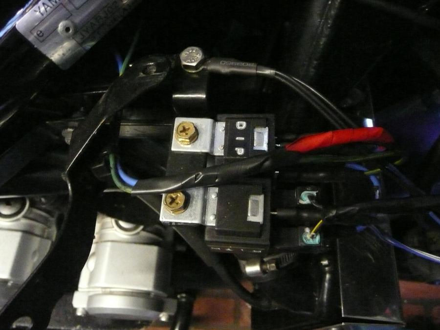

For good measure another view of the relays as well.

You can mount the relays anywhere there is room for them, the dryer the better. If you were increasing the length of wire greatly there would be a slight power drop. But by mounting the relays nearer to the battery you will have a shorter run from battery to the relays and a longer run to the headlamps, so more or less no change. You will probably have a longer run for the wires controling the main beam relay from the original main beam light socket (R.H. side), but as this is only carrying a very small current it won't matter anyway.
The reason I used 40 amp relays is because that is what I could easily get hold off. (From Maplin). Each relay is handling nominaly about 10 amps, maybe a bit more on switching, when the filaments are cold, so anything from 15 amps capacity would probably have been o.k.
