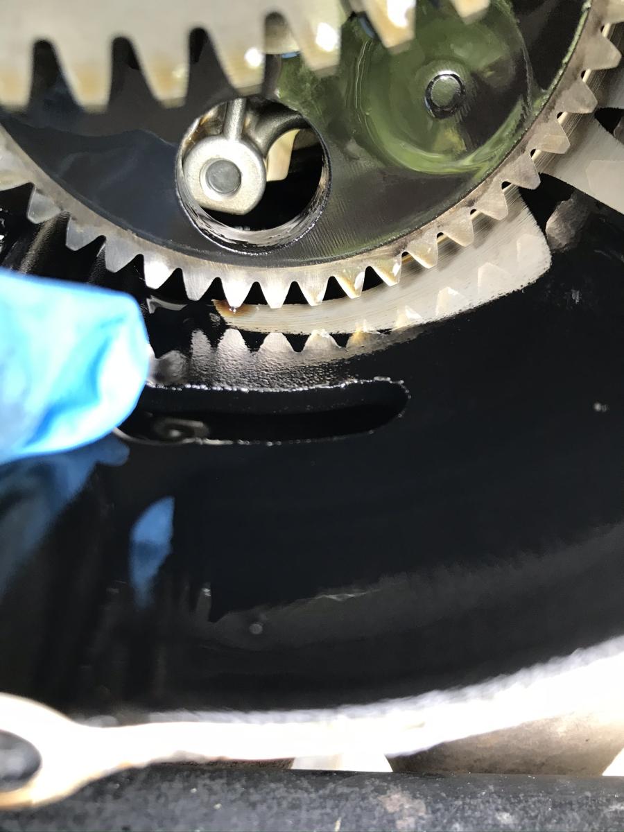

So I thought id share my experience with you as an example of necessity is the mother of invention or in truth borne out of a cock up on my part.
I have a fzs600 2001 its really my winter hack bike , done a few oil changes but on my last one just over a year back I messed up and overtightened the sump plug, resulting in some stripped threads as it weeps but no more than weeps oil past the threads, were talking 3-4 teaspoons over 10-14 days so perfectly livaeble with for a winter hack. I had the idea of helicoil but you cant helicoil in situ and if you are taking the sump pan off may as well buy a second hand sump pan with plug from a breaker . So that was my origional option.
Trouble is ,as you know, you cant take the  sump off without removing the exhaust, ok if your header bolts are going to play ball.
Mine certainly  werent.
Mine had clearly been off once before at least and fought back in the process duly snapping off as was evident by the shortened stumps and motley collection of ugly nuts and studs, so I was not keen to mess with that !
So how else can you do an oil change without draining ?

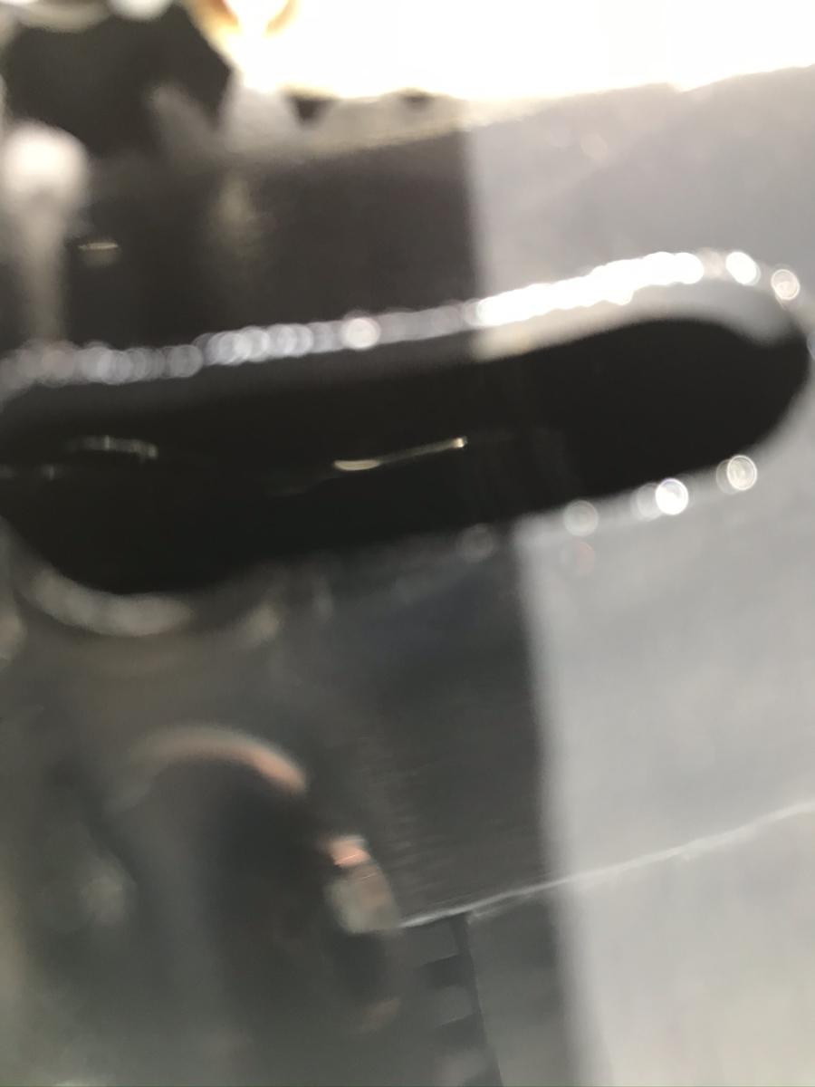

Well if you take off the cluch cover , underneath the clutch drum are two slots about 9 mm slots around 20mm long, these allow fresh oil put in to drain back into the sump.

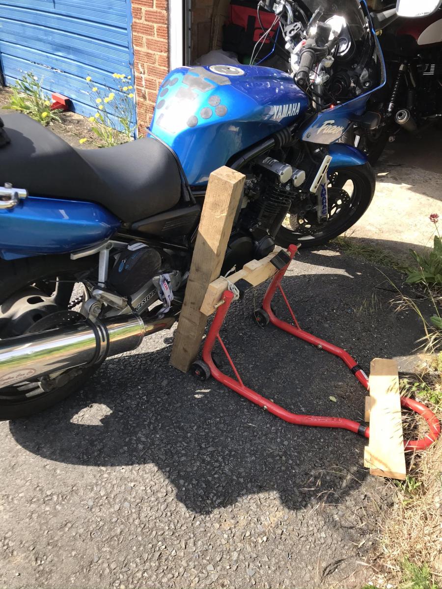

If you can lean the bike over the opposite way to the side stand and about the same lean as on the side stand all the oil comes to that side of the bike.
I got a  12v syphon pump for oil and used 8 mm clear pipe and using the two slots fed the pipe into the sump and moved it around as much as you can and syphoned 3.5 litres of old oil out the same as the manual says to put in following oil & filter change , of cousre I changed the filter too.
Its a bit of a pfaff setting the bike up to do it but its a once a year job and just as sucesful as traditional drain , I got the same qty of oil out as I would have, got to live with the origional sump weep but a weep is all it is.

Well done. I think we all have various bits of wood that have become part of the essential Fazer tool kit. (along with a bag of swear words )

Mate you could have saved all that faff, car vacuum oil changer, through the oil filler cap.  To lean the bike over to the right, apply and secure the front brake lever and tied downs or quality tow rope will do, through the top frame/top yoke and onto a a secure point on a wall, works a treat Wink

(18-06-20, 01:02 PM)Gnasher link Wrote: Mate you could have saved all that faff, car vacuum oil changer, through the oil filler cap.  To lean the bike over to the right, apply and secure the front brake lever and tied downs or quality tow rope will do, through the top frame/top yoke and onto a a secure point on a wall, works a treat Wink
its kind of what i have done really pretty much what youve suggested but you need to get all of the old oil out for sure, even if you laid the bike flat on its side the oil will fill the clutch case to a degree the ony faff i did on top of your suggestion was to remove a cover 8 bolts. other than that its the same.
this at least lets me get a pipe in to the sump pan wriggle it around so i know for sure its all out , i think the extra 8 bolts are worth it to be certain its fully drained.
