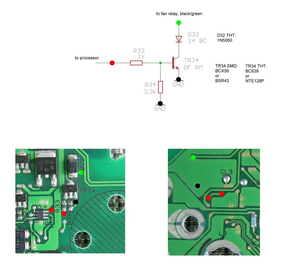

Re: Help Please - Cooling Fan Not Working - schlumpf - 03-03-20 Some more results on searching for the "DF" marking of TR34. Package seems to be SOT-89. Function assumed to be NPN bipolar transistor 80V 1A. Matches: 2SD1898 TFM5213 2SD1623S My best guess for replacements: BCX56 or BSR43 Re: Help Please - Cooling Fan Not Working - Falcon 269 - 03-03-20 OK ... well, not really ... grounding the green/black pin in the cluster connector brought the fan on, so the fault is in the dashboard. Deep joy. All the components look so big in the photo above, so small on the PCB. Doh! Still, if I can source the TR34 replacement based on the info you've supplied this morning, I'll give it a go. Then again, I might just wire a manual fan switch and leave it at that. I've hardly ever had the fan come on in normal riding, even on the hottest days in Spain. Only when spending ages in traffic and that's very rare for me. I used to have a manual fan for those days anyway, so that I could get the cooling started before the coolant got above 90C. Thanks again, Christian. You're a star.
Re: Help Please - Cooling Fan Not Working - Falcon 269 - 03-03-20 Just confirming, is this the part required? https://www.ebay.co.uk/itm/10x-BCX56-10-115-Transistor-NPN-bipolar-80V-1A-500mW-SOT89-NEXPERIA/202687225861?hash=item2f3119a005:g:yLEAAOSwHcBc5nb1 Re: Help Please - Cooling Fan Not Working - schlumpf - 03-03-20 That parts looks fine. But hold on. I'll have a another look to the board this evening. Maybe it's possible to repair from the back side of the board, without removing the old component. Re: Help Please - Cooling Fan Not Working - Falcon 269 - 03-03-20 That would be good. Otherwise, it looks like I have to remove the tacho and speedo from the circuit board to get at TR34. Re: Help Please - Cooling Fan Not Working - schlumpf - 03-03-20 This is my proposal on how to fix the broken fan activation w/o removing any old parts. New parts are added on the lower side of the board, no need for complete disassembly, removing the lower compartment of the dash is sufficient. The circuitry around TR34 is copied and put in parallel to the existing one. This should be fine as it only serves as a simple switch to ground for the relay activation. Unfortunately there are a few more components to be added than simply TR34. The replacement parts are best guesses by taking the marking codes, package type and estimated currents and voltages required for this application into consideration. All are non-SMD. Replacement for TR34 is BC639, 1A/80V. The proposed diode is a standard 2A/400 silicon type (most likely oversized). Resistors are uncritical, smallest package with 200mW rating should be fine. I'm open for discussions and opinions about this solution. Re: Help Please - Cooling Fan Not Working - Falcon 269 - 03-03-20 Deleted due to formatting issues. Re: Help Please - Cooling Fan Not Working - Falcon 269 - 03-03-20 Thanks, Christian. Unfortunately, you are dealing with an utter numpty when it comes to electrical matters. I thought Ohm's Law was a TV series. I'm sure the diagrams and explanation you provided mean something to many here but to me it is still baffling. I can't speak Klingon, either. ![]() I did manage to rig up a manual switch today, tapping in to the green/black at the connector under the left hand fairing infill. I have that running through a 3-pole, single throw LED illuminated switch. Green/black to one pole, earth to another. I can get either the LED to light or the fan to operate but not both together. I tried 576 permutations of wiring connections through the switch before deciding that life was too short to retrain as an electrical engineer. I shall focus my efforts instead on trying to become the oldest player on the PGA Tour. ![]() Earlier, in a fit of enthusiasm and over-confidence, I ordered a ten-pack of transistors to replace TR34. I will spend a few days practising SMD component removal on some old PCBs I salvaged a while ago. There is a fine line between having enough alcohol to steady my hands while keeping my vision clear enough to see the infernal bits. I shall enjoy experimenting to find the perfect balance. ![]() Cheers! Mike PS. Joking aside, I will try to crack the code on your latest suggestion and if successful, I'll add it to the list of things to try.
Re: Help Please - Cooling Fan Not Working - schlumpf - 03-03-20 Sorry for my tech talk, I know it's not everybody's world.. But perhaps you find someone nearby to help with the repair? I could also think about creating a small simple board that's carrying all the parts. As a drop-in module, attached with 3 solder wires? |
