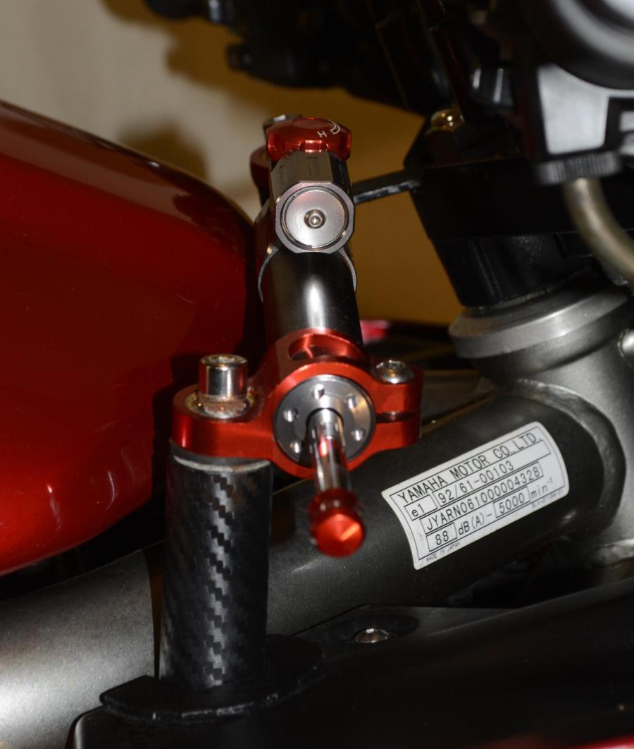

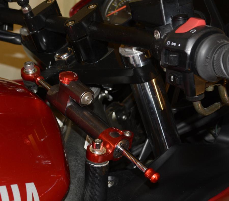

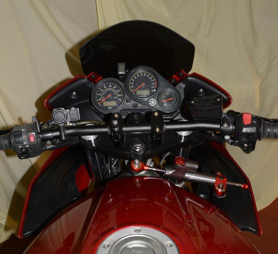

Damper on mine, fitted purely for cosmetic reasons........recent track day had to actually wind it on a couple of turns 'cos of wibbly-wobbly under hard acceleration  :lol

Have you not got that fitted the wrong way round?

Looks it!

Whats the make and model, and go pics of where the damper mounts to the frame..?

Makes no difference which way round the damper is fitted. I made brackets for mine and it's fitted the way shown in pic's for clearance by the tank and when on max' right lock.
It's a cheapy fleabay item; might not say "hyperpro" or "ohlins" but has large effective adjustment range, sufficient length of stroke, good rose joints at the mounting points and build quality looks reasonable......not leaking damper oil yet......
