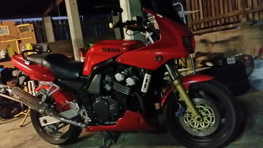

Re: My FZS600, modding in Oz. - Nebuchernezzer - 19-11-15
Fitted my Poland belly pan. Was a bit of stuffing about to get it to fit without the stand hitting it but got it pretty good on the end.
