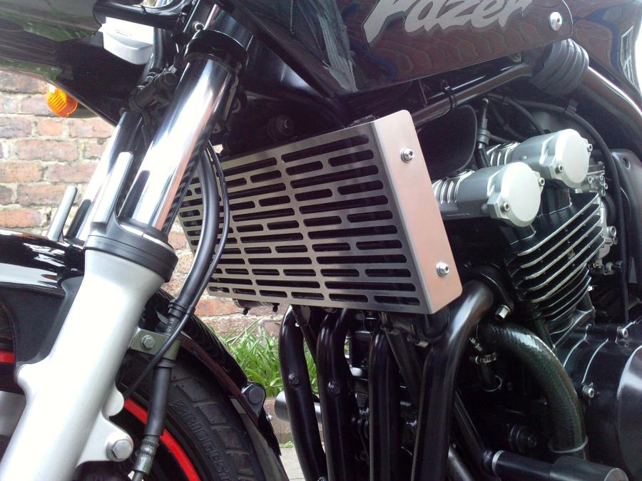

Vulnerabilty of the Rad been getting to me so had this made up from Stainless.. Many thanks to Cousin Derek  :thumbup

Has that bike ever been outside?!  :eek  Nice rad cover too.
Re: A bit more shiney for the fizzer - jonesthesteam - 31-03-14
That is VERY nice, is it a fairly solid construction? (I.e. Not too bendy) I've got an eBay £24.99 jobby on mine and it's okay from a distance but close up its pretty crap, very thin SS which makes it a pain to clean and didn't even fit very well in the first place.

(31-03-14, 05:50 PM)jonesthesteam link Wrote: That is VERY nice, is it a fairly solid construction? (I.e. Not too bendy) I've got an eBay £24.99 jobby on mine and it's okay from a distance but close up its pretty crap, very thin SS which makes it a pain to clean and didn't even fit very well in the first place.
This is 2nd attempt.. 1st one made didnt have the smaller vertical bits to the construction..

Nice rad cover too, would he be interested in making some more?
Chris
Re: A bit more shiney for the fizzer - johna6968 - 31-03-14
Thanks Chris.. I did mention light heartedly to derek about making a few of the rad covers up if there was a demand.. I will speak to him when i get chance and post up his reply..

Thanks all for the positive comments.. Looked at lots of radiator covers on the market and wanted a far simpler 1 off design so I came up with this.. I will speak to Derek to see how viable making more would be, as other rad covers are so readily available on the market for reasonable enough prices.. John

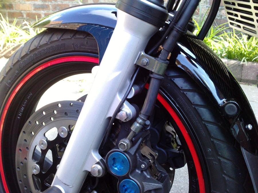

BTW, I routed my speedo cable like that once… not a good idea, eventually it managed to get close enough to brush the disc bolts. The manual shows it should go through the gap between the two caliper mounting points.
Re: A bit more shiney for the fizzer - johna6968 - 01-04-14
(01-04-14, 09:39 AM)Fazerider link Wrote: Damn, that is one clean machine!
Thanks Fazerider for the heads up on the speedo cable routing.. Did seem the logical route to keep things as far outboard from the discs as poss but will check it  :thumbup
Had a check of the speedo cable routing and did run close to the discs the previous way.. Is this the correct route "between the caliper bolts?"
