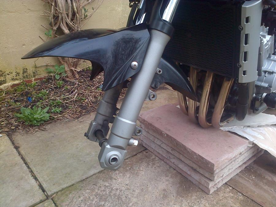

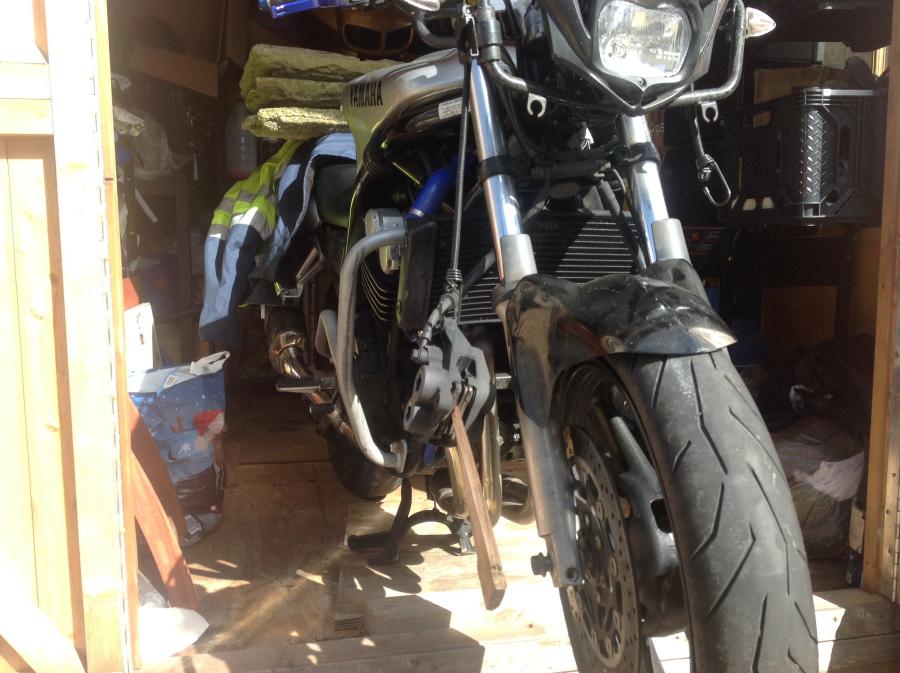

Front end lift - slimwilly - 31-03-14 So the rear is off the floor , no probs, a paddock stand with coaster wheels. How has or what are the ways in the shed to get the front up so that the front wheel can be removed. I have a welder and various hydraulic jacks at hand. Re: Front end lift - fireblake - 31-03-14 Maybe a piece of wood undee pipes and then a small jack to lift it. I had my front wheel out this way. I also used a strap around the bars to a joist in the garage roof as extra support just in case of a slip. Re: Front end lift - Kosmic Kartman - 31-03-14 As Fireblake says. Place bike on centre stand, use small bit of 2"x1" wood under pipes and jack up using scissor jack. Re: Front end lift - red98 - 31-03-14 made this up a few years ago..bike on centre stand rear wheel off the floor slide under front forks and lifts front wheel aswell.... ![]() fits the 600 and the mighty thou...made from scraps of timber and metal brackets all found in the garage...simples Re: Front end lift - Andy FZS - 31-03-14 Your tax has run out .... Re: Front end lift - red98 - 31-03-14 (31-03-14, 08:05 PM)Andy FZS link Wrote: Your tax has run out .... yep....thats "the stuttering one" you see there....thats the last time I used it :o......thinking of taxing it next month.....thinking about it I think ive used the stand more than the bike :lol......... Re: Front end lift - esetest - 31-03-14 I put mine on centre stand , and placed some slabs under exhaust with a an old piece of plasterboard between slabs and exhaust , like this . I could have used a trolley jack and a block of wood . Re: Front end lift - unfazed - 31-03-14 You could always try this :lol motorcycle tyre change while riding! Re: Front end lift - slimwilly - 31-03-14 Yes Red, perhaps i make a stand to go under the fork legs,remember i have no center stand. The rear is held on the axle so there may be too much weight on the pipes that way. Re: Front end lift - esetest - 31-03-14 Unless you have some way of lifting it from above ( girder in your shed or some scaffolding lying around and use a turfer ) ., why can't you wait till the rear is back on , then take the front off . Re: Front end lift - noggythenog - 31-03-14 I used my shed....& a shed load o left over slabs on the back seat to counterbalance. Re: Front end lift - Dead Eye - 01-04-14 Trolley jack and a piece of wood for me - for added security I use two axle stands to hold the frame on the left and right and remove the trolley jack. This way the bike becomes more of a tripod and is more stable when working on it ![]() Re: Front end lift - slimwilly - 01-04-14 Remember i have no center stand, I think i will fabricate a stand that like Reds that seats the fork legs in sockets, fed in from behind the wheel then when the bike is rolled back it lifts the fork legs enableing me to remove the front wheel..=like a front paddock stand but i do not have one :lol Re: Front end lift - Dead Eye - 01-04-14 If you have a paddock stand, why is the lack of centre stand a problem - I may have missed something really obvious here :| Re: Front end lift - slimwilly - 02-04-14 I want to remove the front wheel,,not easy withouta center stand. Re: Front end lift - PieEater - 02-04-14 You can buy front paddock stands for less than £20 including delivery - check out the Busters and Ghostbikes items on ebay - http://www.ebay.co.uk/sch/i.html?_trksid=p2050601.m570.l1313.TR9.TRC1.A0.H0.Xfront+paddock+stand&_nkw=front+paddock+stand&_sacat=0&_from=R40 Re: Front end lift - unfazed - 02-04-14 Remember, always put the rear paddock stand in placed first on bikes without a centre stand before lifting the front with the front paddock stand. Be aware that some of the cheaper front paddock stands will not lift the front of the Fazers high enough to allow the wheel to clear the fender. :eek I have on occasion had to use 2 pieces of wood about 1 inch thick, 6 inches wide and 12 inches long under both sides of the stand before lifting, it was just less hassle than taking off the fender :rolleyes If the rear paddock stand is not in place, when you remove the front axel the bike will become highly unstable :'( Re: Front end lift - bludclot - 02-04-14 i use stainless bars through the axles with paddock stands - cheap to buy and very easy to lift the bike very securely. 12mm diameter for the back and 8mm for the front: http://www.ebay.co.uk/itm/Stainless-Steel-Round-Bar-Rod-12mm-dia-x-600mm-long-/221144818773?pt=UK_BOI_Metalworking_Milling_Welding_Metalworking_Supplies_ET&hash=item337d422455 ![]() with the rear stand in place the front can be lifted by jacking up under the sump and a simple axle stand leaves the bike quite secure: ![]() although i do find that this leaves the steering feeling very light and vague and makes the bike prone to wheelies.... Re: Front end lift - slimwilly - 02-04-14 Front paddock stands are cheap i see , thanks now how does this work? http://www.ebay.co.uk/itm/Yamaha-R1-front-paddock-stand-/271440545969?pt=UK_Motorcycle_Parts_13&hash=item3f331e08b1 Re: Front end lift - unfazed - 02-04-14 I usually put axle stands under the Crash bungs on the 1000 and the engine bars on the 600. Raises the front safely as I do not like putting all the weight through the Down pipes. |
