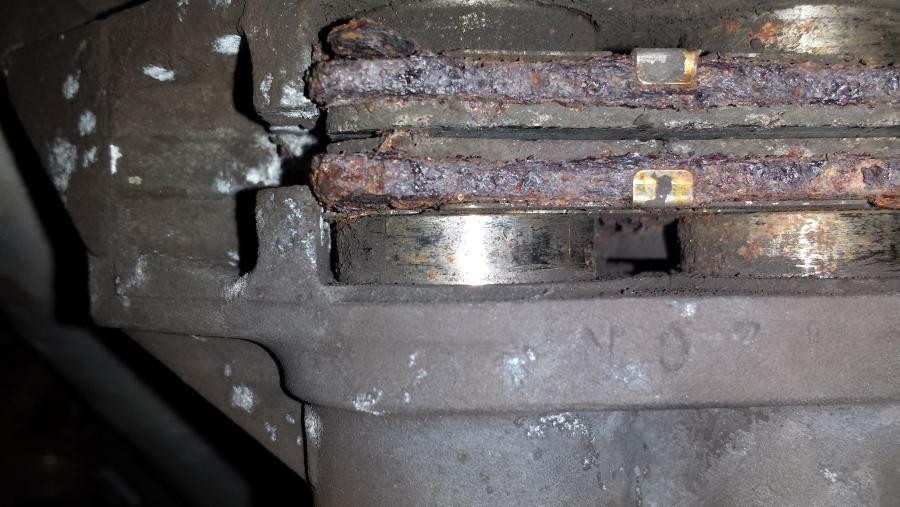

Re: there may be trouble ahead... - bellycgb - 21-07-13
take a look

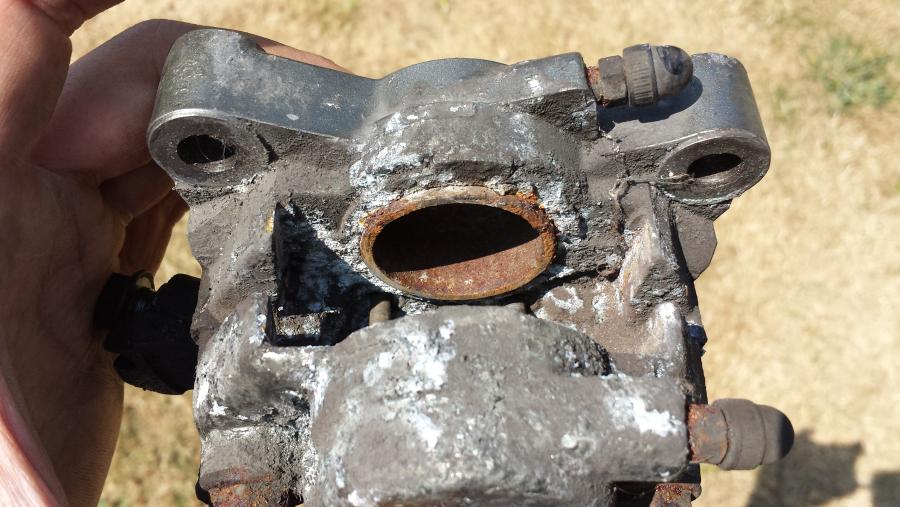

by the looks of it the pistons are shot this is gonna be bloody expensive
Re: there may be trouble ahead... - elbrownos - 21-07-13
Yeah those pistons look stuffed.
I got rear caliper seals and pistons from
http://www.bitzforbikes.co.uk/Yamaha/FZS_600/Fazer_98_-_03/Caliper_Piston_and_Seal_Kits_
and they were fine.
Expensive job eh. Almost £180 to replace all your pistons & seals.

Don't bother buying new pistons for 180, I got both front calipers for 50 and a thou rear (better) for 50 from breakers. You might get some decentish pads with them and they could be serviced to bolt on. Another set of seals might cost you 50 but you'll have some spare calipers to preclean before your next stripdown and you might be able to sort the messed up pots out when you're on the road.
Everything else seems like servicing jobs that won't need doing for another few years. Stick with it and do as much as you can yourself, you'll learn more about your bike and it's very rewarding.

might be an idea, i'll keep an eye out. just stripped both front calipers and as expected the pistons are in a right state. rust and pitting on all of them, mild to very bad. how would i go about cleaning the calipers? as in what cleaner to use?

Hmm, think those calipers need more than just degreaser. I'm sure I've read of restoration jobs where such things were brought back to pretty new-ish standard. Sand/shot/bead blasting? (obviously with suitable precautions taken to protect fluid ways, piston bores etc?) Check classic bike type magazines and sites, they usually have such services advertised, might be worth it.

Personally, i would take up yamy's offer of the second-hand calipers....then bin yours, i fear they are beyond servicing really.
