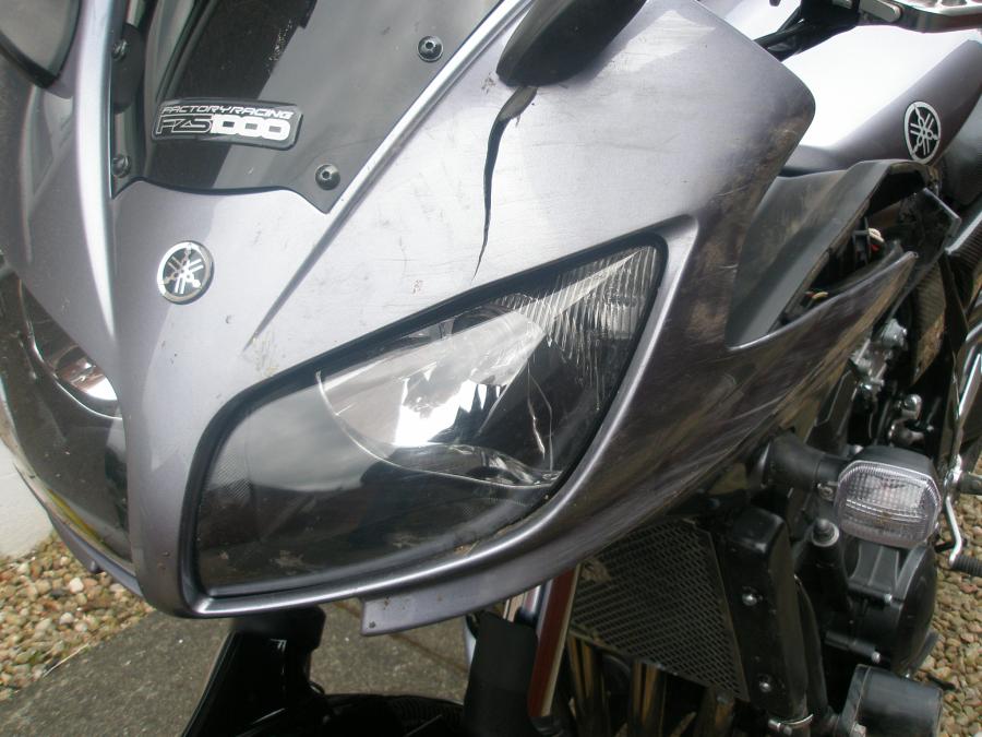

The items that will need replacing are as follows:
Definite:
  • The front fairing
  • The subframe
  • Both inner panels
  • Left hand faring sub bracket (the one the regulator bolts to)
  • l/h rad guard.
Maybe:
  • The headlight - (depending on how many of the mounts have been cracked sheared, you may be able repair. But if the unit is holed may need to be replaced)
  • The radiator - check if its been bent or leaking. If only the mounts have been tweaked your ok.
To Check:
  • Check the forks haven't been tweaked - they look fine from the photos
  • Check the bar are straight - they also look fine.
The reason I have listed the above is only because all of these can be sourced from this forum, from ebay or from breakers. If you hunt around all of these items can be had in good cond. for reasonable prices, I got most of these items from forum/ebay spare for just in case etc.
Should you wish to go down the new route, the total cost for the fairing, panels, s-frame & rad guard would be around £500, but if the headlight needs doing then £700 and if a new rad is required then you can get a pattern one for a fraction of the oem cost at around £150-200 (OEM is £400)

Thanks for advice guys. Took the inside fairing panels off and the headlight has the top left lug broken off, not sure if it will be secure enough with just 3 mounts, otherwise i need 2 fairing infill panels fairing and fairing frame/bracket and one radiator guard. i bent the reg/rect bracket straight. Everything else is just light scratches. The bars are straight, the bar ends are totally undamaged. Bike came off really well considering i avoided a head on collision :faz
