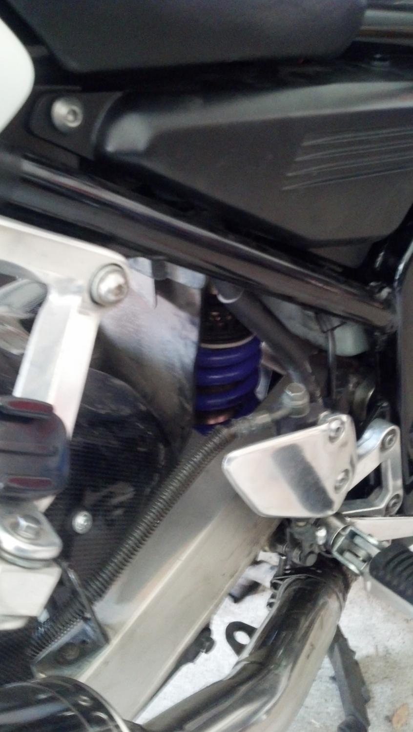

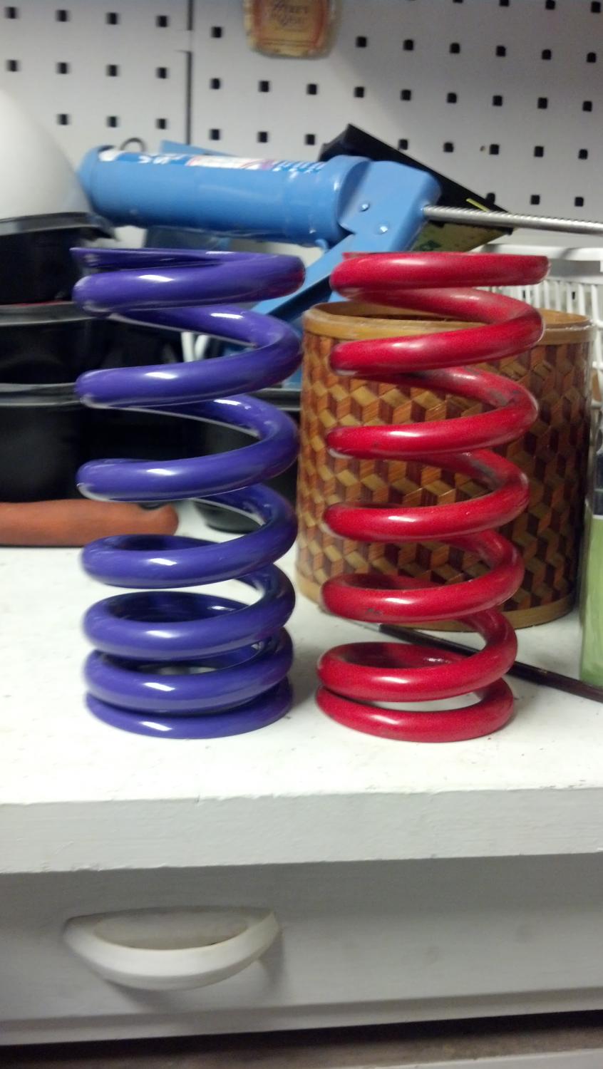

Re: Upgrading Front Suspension - Foxwood - 17-05-13 Picked the kit up this morning and got to work changing the rear shock after work (waiting for the newer fork caps before I install the front springs). Wasn't a big job, just a bit fiddly to get sockets on the nuts. Scariest part was definitely compressing the spring, especially since the tools I had weren't too good. But boy did it change the rear handling! :eek Instant improvement in the way the back end feels. And like FuZzBoM, I too feel that the front end is now lacking. Thankfully, I'll be able to get the rest of the mod done on Monday. Re: Upgrading Front Suspension - risticuss - 17-05-13 Fuzzbom, I think I've bought your bike. I bought it from my brother who got it from a guy in your area who was selling due to just picking up a thou. I even test rode it for him. It has both front and rear hyperpro springs. Gotta say, I'm hanging around the 12 stone mark and even for me it's a fantastic mod. I have no experience of the standard suspension, but I did own a 2000 CBR and this thing handles like that did in the twisties. I've had no problems in the wet or dry and no worries even on the ripply back roads that used to upset my CBR. Might just have to drop the forks a little more though as I'm a touch lighter and think it may be better if I follow what the book says (15mm through the yokes). I can always put it back if the effect is detrimental. Hope this helps anyone else who's looking to refresh their suspension. Simon Re: Upgrading Front Suspension - FuZzBoM - 17-05-13 Awesome job Foxwood, as you can see the Hyperpro spring is much thicker than the original. I take it you are getting the tops with the preload adjusters on? If so good idea. Keep us posted on how it goes. Risticuss - If the reg ends OPY is indeed my old bike Was a sad day to see her go and I am glad she is still being used and enjoyed.I think that there is the benefit of the fazer. Good for a novice as well as an experienced rider. They are also very forgiving and overlooked in my opinion. Having said that Yamaha fit budget suspension and the best thing I have done on both my 600 and 1000 is upgrade it. Out of interest Simon what did your brother go onto? Re: Upgrading Front Suspension - risticuss - 18-05-13 Fuzzbom, Yep, that's mine indeed. I bought it off my brother as he got caught speeding (quite a way over the limit) and his newly married wife told him, "you've had your chance, you blew it". I think he only really looked at it as a toy and wasn't overly into the whole bike ownership thing. It's a fantastic bike anyway. Back on topic, I'd not seen the springs together so I had no idea that they were that different. That definitely explains the reaction to the new spring. Bet you're looking forward to getting the front done now. Re: Upgrading Front Suspension - Motorbreath - 18-05-13 I do not get why yor manuals recommend to drop the fork instead of removing preload. That's what I did when fitted 1 kg/mm linear springs. Afterall the less preload, the more compliant the suspension is. Re: Upgrading Front Suspension - risticuss - 18-05-13 As I don't have anything to compare to, I can only assume that the hyperpro springs push more of the top tube out of the fork lower, by 15mm and so you have to drop them by that amount to get the front ride height back to standard. The preload adjuster would allow a certain amount, but not 15mm. Plus then you'd still have a full range of preload. Wow, it almost sounds like I know what I'm talking about. This is just how my brain has reasoned. Like I say, the springs were already fitted when I bought the bike, so I don't know the standard lengths of the forks. I would assume as well that the guys who make the suspension would know what they're doing, seeing as the kits/instructions are bike specific. |
