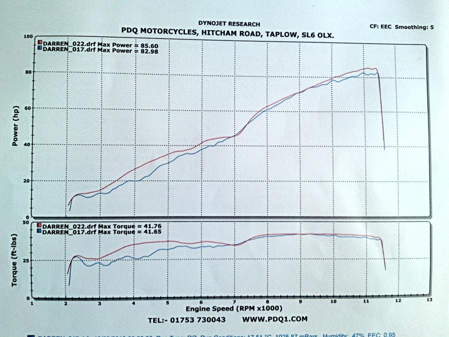

FZS 600 Dyno tune - CharlieDee - 17-02-13 Afternoon Foccors!! ![]() After deciding I need stainless downpipes + K&N + after market silencer + Iridium SP's + 97 RON fuel it really needs to go on the rolling road for a tune up! Just wondering how many of you dudes have had your 600 dyno tuned?? Did it make any huge improvements? Is there anything specific we need to be on the look out for? Has any one got any dyno print outs they could upload onto here? Any feed back would be most appreciated!! Cheers Charlie Re: FZS 600 Dyno tune - darrsi - 17-02-13 Here you go: Re: FZS 600 Dyno tune - darrsi - 17-02-13 I think i had it checked out for a slight hesitation issue, but he did a full carb clean up and made sure everything is where it should be. It didn't need re-jetting or anything, and i have aftermarket pipes, end can and a K&N filter. Re: FZS 600 Dyno tune - limax2 - 17-02-13 Interesting graphs darrsi. Are both lines with the the aftermarket pipes, end can and K & N fitted? The difference being due entirely to cleaning and adjustment of the carbs? Re: FZS 600 Dyno tune - darrsi - 17-02-13 (17-02-13, 06:32 PM)limax2 link Wrote:Interesting graphs darrsi. Are both lines with the the aftermarket pipes, end can and K & N fitted? The difference being due entirely to cleaning and adjustment of the carbs? Actually now you've said that, this graph was when i had a normal air filter in it, which would've been an ill fitting Hi-Flo type.. I've had it dyno'd since this one with the K&N in, but he never gave me a print out, and i forgot to ask for one. :rolleyes He did say to me that the K&N doesn't make too much difference BHP wise on Fazers that he's ever seen, whereas he said they do make a big difference to a Bandit for example, even though the bike blatantly feels better when riding with one fitted. Re: FZS 600 Dyno tune - Motorbreath - 17-02-13 This graph shows what the little link pipes do: http://fazerowners.yuku.com/topic/29705/Why-has-no-ivanised-600-s#.USEblfLEVK0 Here there are more: http://foc-u.co.uk/index.php?topic=4800.0 Re: FZS 600 Dyno tune - CharlieDee - 18-02-13 Cheers guys, much appreciated :lol Re: FZS 600 Dyno tune - willmckeand - 24-02-13 Not strictly relevant I know, but check out the print out for my restricted fazer....not even 33bhp! Re: FZS 600 Dyno tune - Will.I.Is - 27-02-13 This was running rich with a touch of clutch slip hence the dip about 9 seconds in the slip has now gone away so I want to take it back up to get a better reading over the rev range Re: FZS 600 Dyno tune - Revilo18 - 27-02-13 Hi - where's a good (i.e. not a rip off) place to get a Dyno tune done? Preferably in the South - even better within the M25.... thanks in advance. Re: FZS 600 Dyno tune - darrsi - 27-02-13 (27-02-13, 01:19 PM)Revilo18 link Wrote:Hi - where's a good (i.e. not a rip off) place to get a Dyno tune done? Preferably in the South - even better within the M25....The address is on my Dyno graph above! Their hourly rate is £60 for work done, which would have the Dyno thrown in. http://pdq1.com/dynojet-tuning-center.php Re: FZS 600 Dyno tune - Revilo18 - 27-02-13 doh! Thanks. Re: FZS 600 Dyno tune - darrsi - 27-02-13 There's these places too : http://www.superbikehire.co.uk/?gclid=CP3Z45LM1rUCFYbHtAod2hEA3g http://www.cbswhitton.co.uk/contact.html http://www.stevejordanmotorcycles.co.uk/dyno.asp Re: FZS 600 Dyno tune - CharlieDee - 22-03-13 Had the Beast on the dyno today and managed the following: 85.94BHP 42.24 max torque Will get the graphs up later ![]() Re: FZS 600 Dyno tune - packie - 22-03-13 (22-03-13, 07:37 PM)CharlieDee link Wrote:Had the Beast on the dyno today and managed the following: ....pretty close to Darrsi's bike too! Re: FZS 600 Dyno tune - red98 - 22-03-13 anyone know what the bikes had when they were new ? Re: FZS 600 Dyno tune - packie - 23-03-13 (22-03-13, 10:01 PM)red98 link Wrote:anyone know what the bikes had when they were new ? On MCN's review, it is quoted as 95bhp....but I guess that is not at the back wheel on a Dyno. I noticed that MCN has changed the average fuel consumption to 55mpg. I think they had it at around 40mpg a while back. Pity the muppets didn't take the time (2 minutes) to check to see how this change would impact its review. If they did, then they would have noticed how this statement would now seem silly and contradictory...... "Apart from its thirst for fuel it would make a great despatcher's motorcycle." Re: FZS 600 Dyno tune - Dead Eye - 23-03-13 I swear it is a pet peeve when journalists can't be bothered to run their articles through spell checkers. It's their damn job to write content after all and it should be done professionally - note this is in relation to the fact that they spelt "dispatchers" wrong *sighs* It just rubs me completely the wrong way and some are a lot worse than others. English is becoming a very rare language... Sorry for that little outburst ![]() Re: FZS 600 Dyno tune - darrsi - 23-03-13 STP & Activ8 in your bike is similar to watching the film Coccoon..... :b Re: FZS 600 Dyno tune - darrsi - 23-03-13 95bhp is the bog standard brand new, 83+bhp is the norm in this day and age, any more than that is a well looked after bike! |
