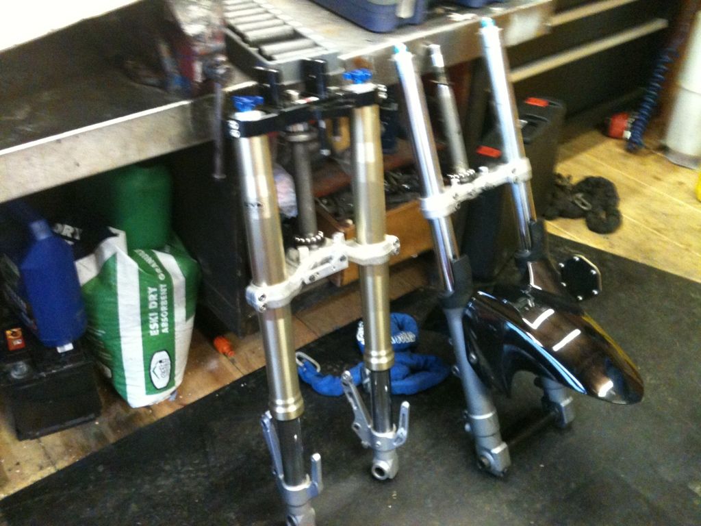

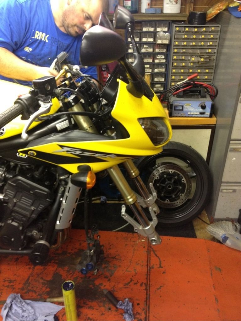

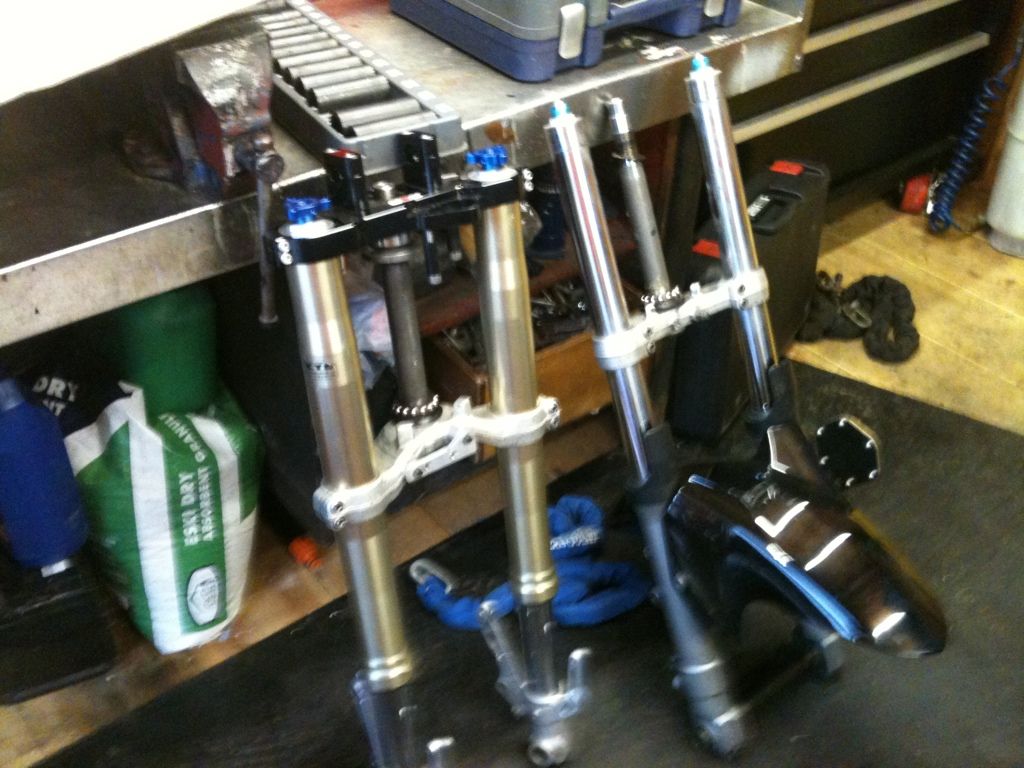

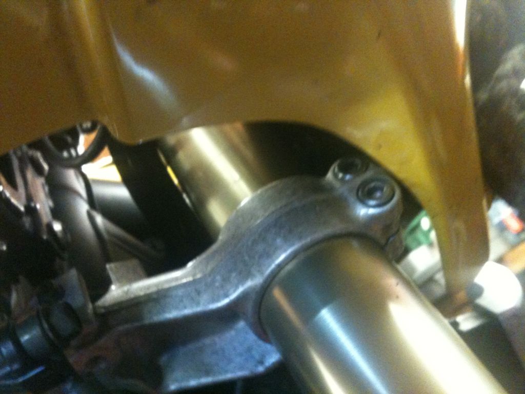

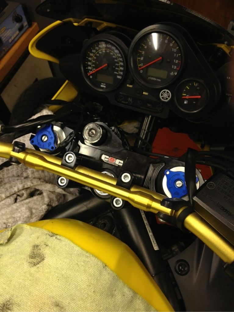

r1 front end - rjd1 - 26-08-12
front end on just tidying up then road test
gettin ignition security bolt`s out were a mission good old dewalt had to remove it from bike
need new horn bracket
also need to space nose fairing out slightly as it rubs
apart from wee niggles not a bad job
cant wait to test them out few pics
[Image: 1816AD40-79A5-4F70-8537-D99EA7BE8783-169...57DED0.jpg]
[Image: D265676F-546C-4672-B08C-3D683F800E6E-169...5D6100.jpg]
r1 front end - cable tie - 26-08-12
I'm puzzled as to why you say it rubs!! there should be no need to space the fairing out whatsoever.
I've done 3 conversions on gen1 's and never have they rubbed on the farings, what yokes have you used !!

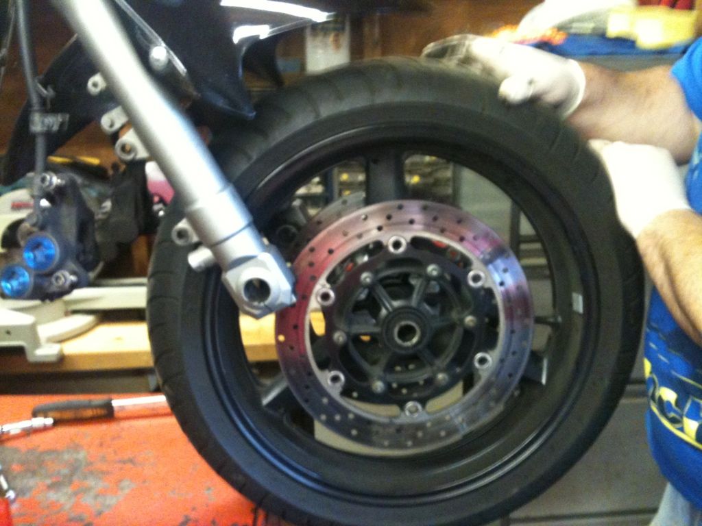

Re: r1 front end - rjd1 - 26-08-12

Re: r1 front end - Falcon 269 - 26-08-12
(26-08-12, 01:29 AM)cable tie link Wrote: I'm puzzled as to why you say it rubs!! there should be no need to space the fairing out whatsoever.
I concur.  Something not right here.
Has the bike been in an accident that could have bent the fairing stay or worse - obviously - the steering head?

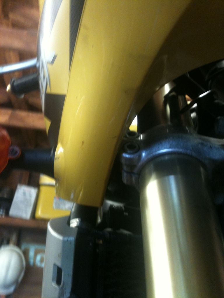

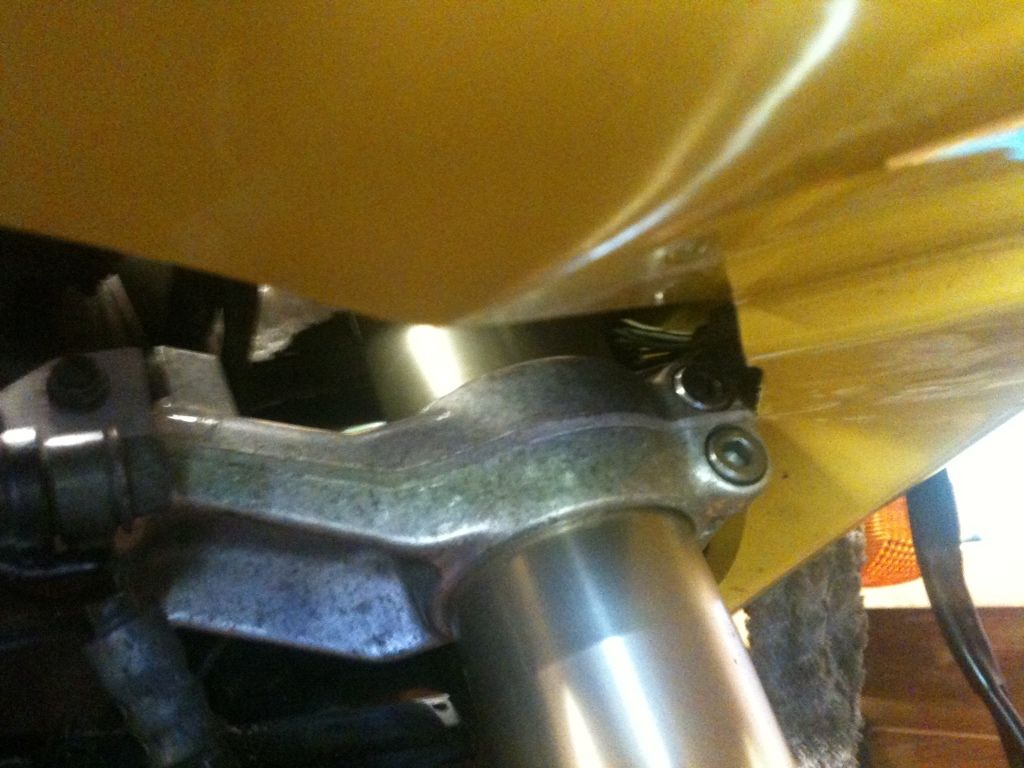

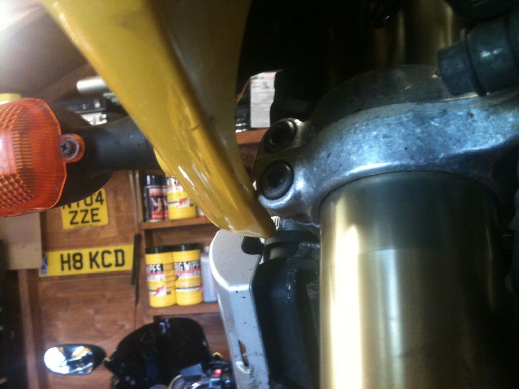

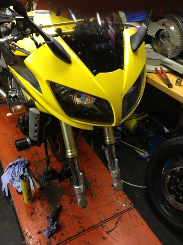

Re: r1 front end - rjd1 - 27-08-12
no evidence of previous damage but bottom clamp defo touching both sides
[Image: 1619AF85-6A49-4898-9FD0-FFC6D4AB32B8-229...E9779D.jpg]
[Image: EDAFF335-C6ED-42C0-AB8C-E1467983CC1F-229...1D6188.jpg]
[Image: 715EEFB6-142E-41DB-B0C3-E02F29AAEE3D-229...6D5247.jpg]
[Image: 5EB7B922-6DBF-45EF-AF9A-E1CD04DA7B29-229...86F001.jpg]
[Image: 01053153-3615-43A4-8A1C-F3A893AF730C-229...2C86DE.jpg]
Re: r1 front end - Falcon 269 - 27-08-12
I'll check mine later this morning and get back to you.
That definitely doesn't look right, though.
Mine has 1cm clearance both sides with the forks straight ahead.  Same clearance all the way as I turn the bars fully to the lockstops in either direction.  Yours ain't right, sorry. Sad
Could it be a pattern aftermarket fairing?  Something doesn't look quite right with it but hard to tell for sure from the photos you've posted.
Not sure, but might it be a fairing from a fox-eye 600?

Re: r1 front end - sadlonelygit - 27-08-12
your bottom yoke is too low compared to mine.
did you fit the the yokes with the fork legs attached?
i did.......once. the bearing didn't sit correctly against the race.
thinking logically, did your old forks touch, if not, then either you have assembled it wrong or tommy has sold you a lemon.
take it off, measure the height of the steering stem on both yokes to see if they're the same, if so then you're a numpty Wink

Re: r1 front end - sd1 - 28-08-12
I dont understand how you can say the bottom yoke is lower. it has the stem pressed into it, it goes all the way up into the frame and is tightened at the top, i dont see how the lower yoke could be moved up or down. am i missing something here?
I had a look today with rjd, everything looks spot on, apart from the lower yoke touching the fairings, what i really cant understand is the post that says they have 1cm gap between fairing and forks, is this 1cm from yoke?? because the only way i could see you having 1cm is if 1, your fairing has been chopped, 2, your yokes are not as wide, (but then fork spacing wouldnt be correct and wheel etc wouldnt go on) or 3, rjd has a pattern front fairing,
Any chance of some pics of these r1 front ends on your bikes? just for reference.
Cheers
Re: r1 front end - sadlonelygit - 28-08-12
(28-08-12, 08:04 PM)sd1 link Wrote: I dont understand how you can say the bottom yoke is lower. it has the stem pressed into it, it goes all the way up into the frame and is tightened at the top, i dont see how the lower yoke could be moved up or down. am i missing something here?
yes you are.
the steering stem doesn't go all the way through the bottom yoke, it actually protrudes 10mm, and has to be pinned/held in place as it isn't an interferance fit like the original fazer stem.
the bearings are narrow profile races and have to be lined up with a degree of care.
still wondering if the old headraces were taper roller as the races are different.
