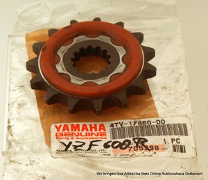

Hi All,
My service manual and Yamaha part finder http://parts.yamaha-motor.co.uk/ypec_b2c/
say the front sprocket for my 2003 5RT4 model is: 4TV-17460-00
Fowlers part finder says different number?
3HE-17460-00
Any idea which one I should buy?
thank you
cheers
Val

That what I was thinking initially too, however OEM front sprocket has 8 holes and a big red rubber thingy attached which any of aftermarket ones lack. Look at riedrider photo and you will see it.
I have digged out in forums and although nobody so far is sure why is that (given the fact that is the only sprocket in the world that has such feature) some guys suggested that may something to do with noise and calming the chain movement. I have looked at pictures of some old used ones and you can see clearly the marks from the chain there too.
Anyhow long story short the price difference for the front one is not so huge as for the rear one, OEM one is £24 any aftermarket is around £10.
Hence I decided to go for OEM front and Renthal rear :-)
Probably will get the one 4TV-17460-00 recomended in Yamaha online parts finder and will buy it from Fowlers, Fowlers say its for YZF600R however I tend to beleive Yamaha and my service manual LOL

Not likely given the fact that on BOTH places where they sell 4TV-17460-00 AND 3HE-17460-00 Fowlers have the old 9mm nut as their part number for sale, LOL: 90179-18020
The new one 12mm is 90179-18006 which I will buy from ebay as a kit with the washer:
[url=http://www.ebay.co.uk/itm/GENUINE-YAMAHA-FZS600-FAZER-FRONT-SPROCKET-NUT-AND-WASHER-KIT-/141276105948]http://www.ebay.co.uk/itm/GENUINE-YAMAHA-FZS600-FAZER-FRONT-SPROCKET-NUT-AND-WASHER-KIT-/141276105948
[/url]
I even will not bother to speak with Fowlers parts department, if you can't fix your parts referal system what is the point to speak with somebody over the phone to hear him saying "you will be fine trust me" LOL

The correct sprocket for the FZS600 is the 4TV one (4TV is Thundercat model code from which the FZS600 engine is derived and shares many  gearbox parts), the 3HE one is for the FZR600.
It probably will fit as JT Sprockets list the same sprocket for both bike, but there must be some difference for Yamaha have to different part numbers on them.
