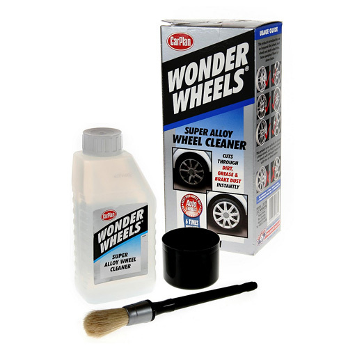

« Reply #57 on: 04 May 2015, 09:40:11 pm »
I have recovered worse calipers than that. Obviously a replacement Fzs1000 or post 2009 Xjr1300 caliper is the easiest option
I use wonder Wheel alloy wheel cleaner to clean up the caliper first.
WONDER-WHEELS-SUPER-ALLOY-WHEEL-CLEANER-KIT-SET-1LITRE-CAR-AUTO-EXPRESS-BEST-BUY height=268 height=213
Use with care as it is acid based, follow the instructions exactly, then wash it down well. Check if you can open the bleed nipples and then remove the pistons if possible. You need to check the seal slots. If the seal slots cannot be cleaned up than replacement is the only solution.
If the nipples are removable and seal slots can be cleaned up; replace pistons and seals and nipples if necessary.
Dismantle the two sides only as a last resort as the small seals can be very difficult to get.

Often times they look much worse than they actually are. :)
The spring at the bottom of the caliper comes out with a bit of fiddling, it is to keep pressure on the pads and stops them rattling. Replace the slid pins also.
The alloy wheel cleaner will get most crap off the piston also without damage, I normally use a sharpen piece of very hard plastic as a scraper for the tough bit and since it will be softer than steel it won't damage the pistons. Not to keen on using wet and dry.

OK ordered some Wonder Wheels....lets see what it does to the pistons
If it saves me using anything too mechanically abrasive thats good....just let the chemicals do their job...
