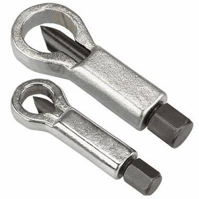

If in doubt, use a nut splitter and clean the threads with a 6mm die

Well I got 6 off no problem, sheared one and rounded off the nut on another. Like the nut splitter idea but doubt I'd get it in around the nut its the one under the oil feed pipe so not a lot of room. I think I'm going to have to cut the pipes off to get access. These studs should be at least 8mm!!
I don't know if my nuts are standard but they are long with a hex recess for an Allen key.
