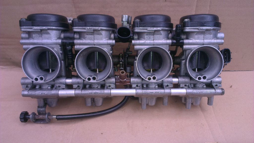

I fucked about tried cleaning my low mile originals 3 times with they've only done 10,000 miles !
Tried 4 other sets until I got some that worked perfectly,I found out its not just jets there's a few tiny orafaces inside that clog too.
The jets also get yellow/green gunge inside them you cannot easily clean or even get to,the best option is to buy new emulsion tubes, jets etc & replace the rubber parts too.
My low mileage set needs about £80 or so spent to make them good,we've got the EU & the shitty petrol they sell to thank !
Those tiny orifices are the transfer ports. If you look at the carbs on the airbox side you see two air jets. The one on the left is the pilot air jet
At idle air is drawn through that jet down a small orifice and it goes into the holes in the side of the pilot jet and out the narrow end of the jet.
That draws fuel up from the bowl at the slotted end of the pilot jet and up through the center of the jet and the air fuel mixture goes down another orifice and comes out of the small holes on the engine side of the butterfly valve called transfer ports. The transfer port orifice is joined to the the mixture screw orifice so the air fuel mixture also comes out at the mixture screw hole. Turning the screw in blocks the hole and turning it out lets more fuel through.
That's how the idle circuit works and all of the passages have to be clear not just the jets.
There's a good diagram of what I'm saying. The left side is the airbox side

It's more about throttle position than rpm. If the flat spot is at 1.5-2k you'd only have the throttle open a tiny bit so I'd estimate 90% or more of your air/fuel mix would be from the pilot circuit. If you're having a flat spot there and you think it's fuel related you should clear out the pilot air jet, pilot fuel jet, mixture screw and very importantly the transfer ports because that's where the fuel comes out. If the transfer ports are blocked cleaning out the jets isn't going to solve the problem. The transfer ports are so small that carb cleaner or an ultrasonic cleaner is the best way to dissolve the crap and old varnished petrol. After everything is clean adjusting the mixture screws and balancing the carbs would also help but everything has to be clean first

It can do. But how is the bike running is the important question I don't think you mentioned that. What is it doing? Is it lumpy at idle? Is it mis firing when you open the throttle? Does it feel down on power when you're riding? If you've got a mis or a cylinder that isn't contributing you can use the water on the exhaust trick to show which cylinder is the problem cylinder. If the bike is running ok and there's no mis and there's still a difference in exhaust temperatures it can be caused by a rich or lean mixture. The leaner the mixture is the hotter it burns and the richer the mixture is the cooler it burns so if you do the water on the exhaust trick and it can give you an indication of rich vs lean on each cylinder, also if you take out the spark plugs and read them. Black and sooty is rich, white is lean, wet is no spark, and you combine that with the exhaust temp you can get an idea of the problem.
